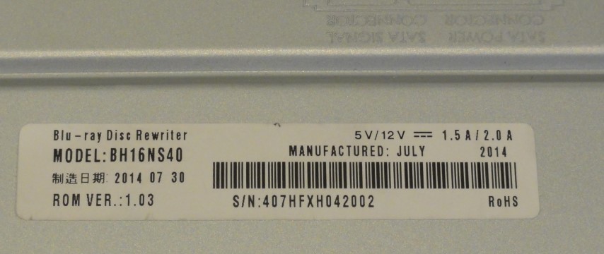

i try to read UHD Disk with MakeMKV Version V1.10.08 but it don´t work (no disk insert)
Laufwerksinformation
OS-Gerätename: F:
Produzent: HL-DT-ST
Produkt: BD-RE BH16NS40
Revision: 1.03
Firmware-Datum: 2114-03-26 11:15:
Markierungen der Bus-Verschlüsselung: 17
Highest AACS version: 63
BH16NS40 (Small).jpg (75.44 KiB) Viewed 34546 times
Is it possible with this Version ( SW and HW ) to get it work?
Re: UHD drives
Posted: Sun Dec 17, 2017 4:26 pm
by Woodstock
PauleFoul, neither of us has the NS50 version of the drive, so I think we are out of luck on that. I hate it when manufacturers use the same model number for incompatible versions of the hardware. :roll:

Woodstock wrote:PauleFoul, neither of us has the NS50 version of the drive, so I think we are out of luck on that. I hate it when manufacturers use the same model number for incompatible versions of the hardware. :roll:
Means it is important for these both models
- LG WH16NS40
- LG BH16NS40
to have the NS50 Version?
And what is with the Asus BW-16D1HT? Also has such HW Versions or is there only the Firmware-Version important?

With the LG drives, it is apparently VERY important that it have the "SVC code: NS50" mark on the label. If it isn't there, the drive won't read BDXL.
