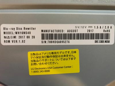

Just to let everybody know, I got my WH16NS40 from NewEgg (NJ warehouse) and it came with SVC code NS50 but ROM v1.03 (firmware?) and a date of 11/2017.
I'm going to install it tomorrow and downgrade it. I'm assuming even though it appears to have come with 1.03 that it can still be downgraded and work OK with UHD?
TeddyRaspin
Posts: 202
Re: UHD drives
Post by TeddyRaspin »
You should first dump your 1.03 firmware before downgrading.
Anyway, it can be downgraded and made UHD friendly again.
