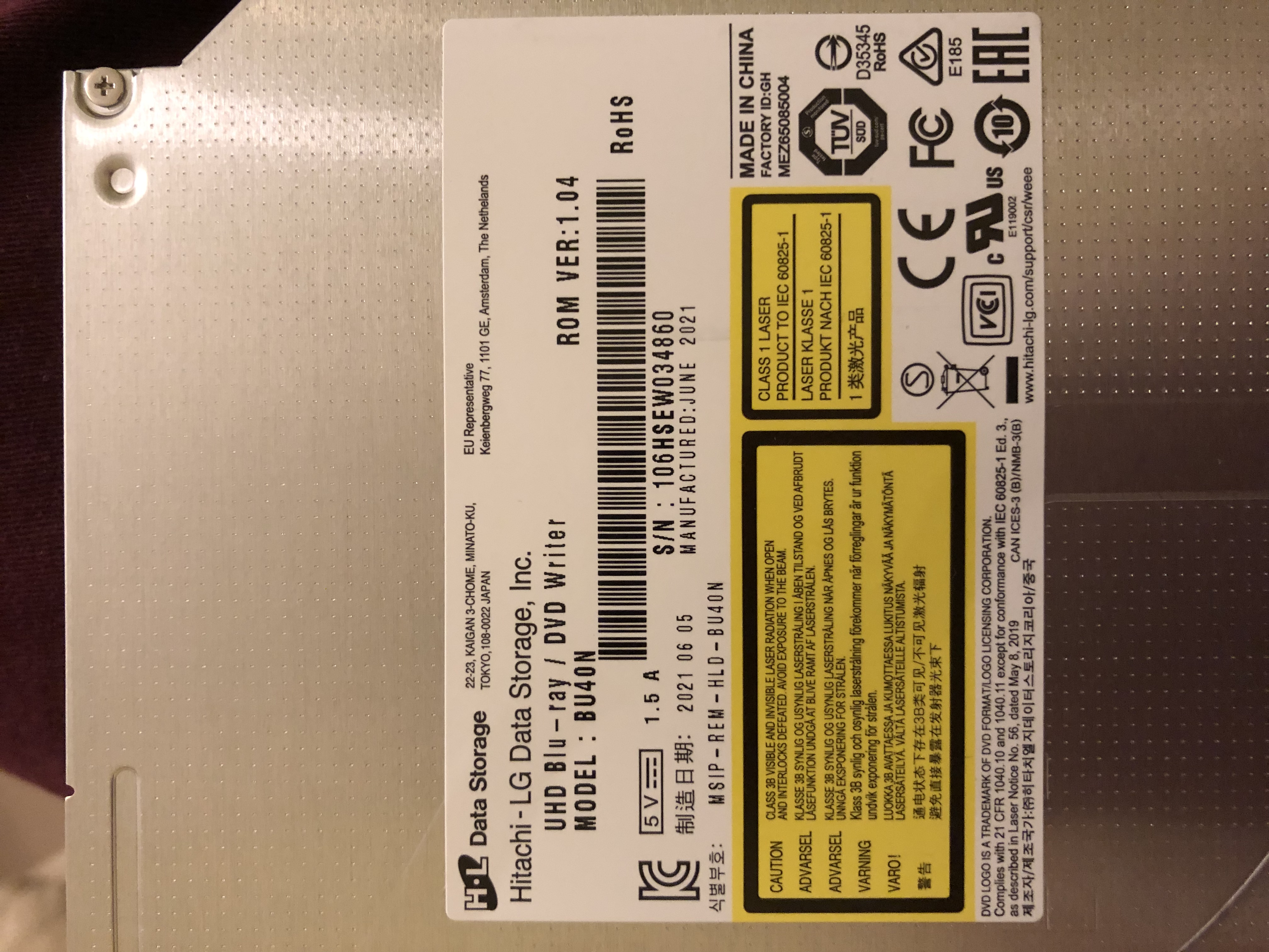

Can anyone tell me if this drive is flashable to 1.03mk? Can’t find the SVC number…
Lmk if this is the wrong place to post this, and where I should post it instead.

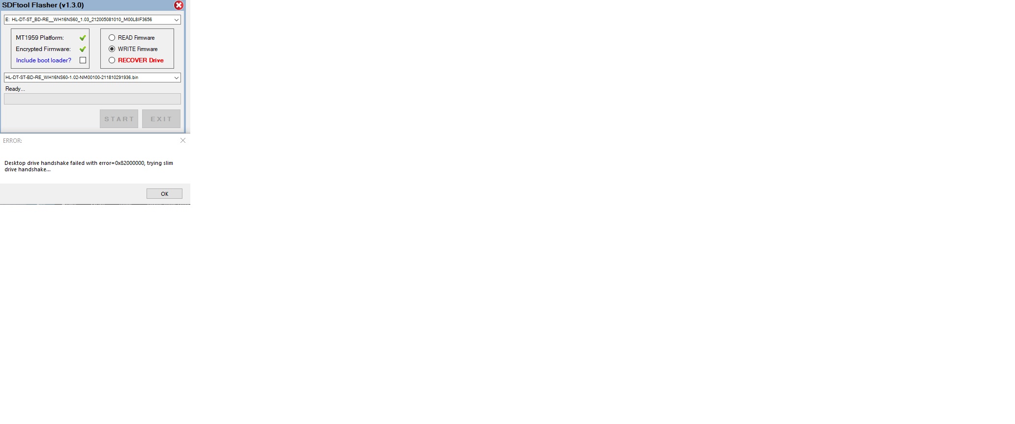

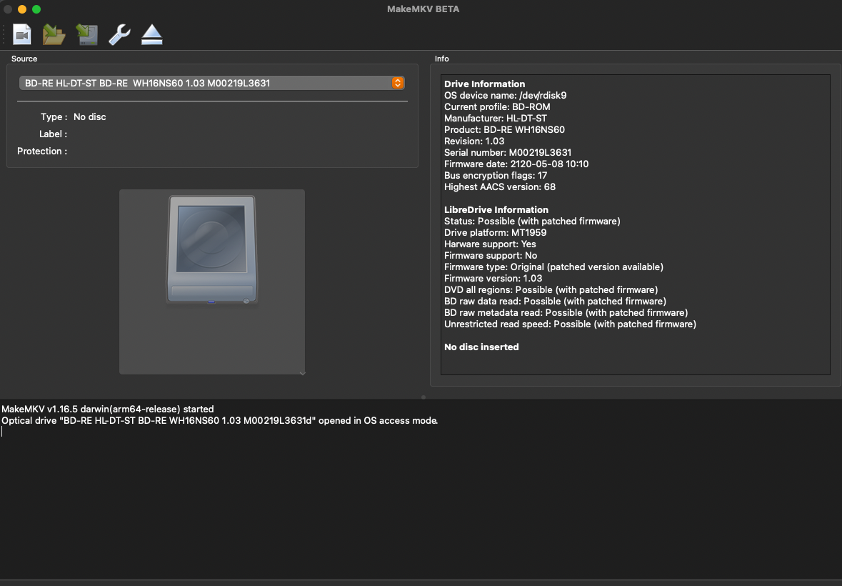

Hi, I have tried the steps on multiple platforms for flashing a WH16NS60 Version 1.03 inside of the Vantec NST-536S3-BK 5.25 case. Both items are brand new and seem to be working, I can load a blu ray and play it and MakeMKV detects the disc easily. But I continue to get the following error on my mac when I attempt to flash it down to Version 1.02:
/Applications/MakeMKV.app/Contents/MacOS/makemkvcon f --drive /IOBDServices/68B4B4E0 --sdf-file /tmp/sdf.bin rawflash enc --in /tmp/HL-DT-ST-BD-RE_WH16NS60-1.02-NM00100-211810291936.bin
Reading input file /tmp/HL-DT-ST-BD-RE_WH16NS60-1.02-NM00100-211810291936.bin
Current Drive ID: HL-DT-ST_BD-RE__WH16NS60_1.03_212005081010_M00219L3631
Desktop drive handshake failed with error=0x82000000, trying slim drive handshake...
Write flags NG 05/24/00
Command produced error code 0x8f052400
I have tried flashing on MacOS, Windows 10, and using the newest flashing tool and all gave the same error. I am wondering if the problem is the enclosure (I have tried swapping to multiple ports). Any help and experience with this issue? I did try to do my homework and search the forums but I can't find anything regarding the "Desktop drive handshake failed..."

Hello all! I'm hoping someone can help with the issues I've had trying to flash my drive. I've had a nightmare trying to get a working usb-sata connector, the first two wouldn't even power the drive.
Specs first:
OS device name: E:
Product: BD-RE WH16NS60
Revision: 1.03
Firmware date: 2120-05-08 10:10
Highest AACS version: 50
Harware support: Yes
Firmware support: No
Firmware version: 1.03
Enclosure: Vantec NST-536S3-BK
Issues with SDFTool This error is followed up with: Command produced error code 0x8f052400
The same error is showing up in Command Line
Thanks for any help!

Sorry for the noobish question, I've been a reader here for awhile, recently decided to rebuild my pc and the cases I like no longer have full sized optical drive bays. I see that in some cases the slim drives are better anyway. So it looks like the lg BU40N is sold out pretty much everywhere. There are a lot of clones/ads on amazon that claim to be that drive, but no way to tell for sure. Does anyone have any in stock reputable links for known good sources of these drives?
I've searched around, but many are not labeled LG and I don't want to buy a bunch and find out I've got the wrong ones.
for example:
https://www.amazon.com/HLDS-BU40N-Inter ... 248&sr=1-3
is this one legit? It seems like the LG drives are made by HLDS, but they're not labeled LG..

You are good the BU40N has no svcSelkeph wrote: Fri Dec 31, 2021 5:17 pm Can anyone tell me if this drive is flashable to 1.03mk? Can’t find the SVC number…

Hmm I'm getting multiple reports of the new vantechs not working unless you are the one who emailed me too may remove it from this list for safetyitsvoodoo wrote: Thu Jan 06, 2022 3:29 am Hi, I have tried the steps on multiple platforms for flashing a WH16NS60 Version 1.03 inside of the Vantec NST-536S3-BK 5.25 case. Both items are brand new and seem to be working, I can load a blu ray and play it and MakeMKV detects the disc easily. But I continue to get the following error on my mac when I attempt to flash it down to Version 1.02:

I did not email, but do you have a recommendation for working adapter? I think I may switch to the BU40N and was planning to get the compatible Vantech for that, but if its having problems I may try something else.Billycar11 wrote: Thu Jan 06, 2022 10:50 pmHmm I'm getting multiple reports of the new vantechs not working unless you are the one who emailed me too may remove it from this list for safetyitsvoodoo wrote: Thu Jan 06, 2022 3:29 am Hi, I have tried the steps on multiple platforms for flashing a WH16NS60 Version 1.03 inside of the Vantec NST-536S3-BK 5.25 case. Both items are brand new and seem to be working, I can load a blu ray and play it and MakeMKV detects the disc easily. But I continue to get the following error on my mac when I attempt to flash it down to Version 1.02:

+1 on this. I've tried two 1099NEW s and 1 vantec. Given that I have a 5.25 drive, should I just plug straight into SATA for the flash process on an older computer at this point?Billycar11 wrote: Thu Jan 06, 2022 10:50 pm
- Posts: 5820
sorry guys this is the first im hearing of on the 1099 no working things just got more inconvenient in the flashing world i will move those two the not flashing section.itsvoodoo wrote: Thu Jan 06, 2022 10:55 pmI did not email, but do you have a recommendation for working adapter? I think I may switch to the BU40N and was planning to get the compatible Vantech for that, but if its having problems I may try something else.Spoir wrote: Thu Jan 06, 2022 11:16 pm
yeah best bet would be to do it over sata the owc may still work unless they all use the same updated chipset.
by any chance are you guys running windows 11 with tpm? that may have something to do with it
I tried on MacOS and Windows 10, those are the platforms I tested on. I do not run Windows 11 but can’t figure that it’s a Windows 11 specific deal. I’ll flash via sata and then try to see if the it will still rip in the enclosureBillycar11 wrote: Fri Jan 07, 2022 12:58 amsorry guys this is the first im hearing of on the 1099 no working things just got more inconvenient in the flashing world i will move those two the not flashing section.itsvoodoo wrote: Thu Jan 06, 2022 10:55 pmI did not email, but do you have a recommendation for working adapter? I think I may switch to the BU40N and was planning to get the compatible Vantech for that, but if its having problems I may try something else.Spoir wrote: Thu Jan 06, 2022 11:16 pm
