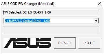

I am trying to flash a Buffalo BRXL-PT6U2VB-EU drive but I am always getting "Updating Failure #1" which seems to indicate an incompatible drive.
Manufacturer: BUFFALO
Product: Optical Drive
Revision: 1.00
Serial number: WR19 151***
Highest AACS version: 28
Date of manufacturing according to sticker on packaging: April 2019
I am using the modified ASUS flasher from here
ASUS ODD FW Changer (Modified).jpg (13.24 KiB) Viewed 15482 times
Firmware versions I've tried unsuccessfully:
- DE_LG_BU40N_1.00.bin
- HL-DT-ST-BD-RE_BU40N-1.03-NM00000-211810241934.bin
- HL-DT-ST-BD-RE_BU40N-BU12-OM01001-211902230922.bin
- HL-DT-ST-BD-RE_BU40N-BN12-0M01001-211905141415.bin
- The drive itself works, I briefly played a regular Blu-ray movie.
- Disabled anti-virus software for the flashing process.
- I have tried 3 different USB 2.0 and 3.0 cables on USB 2.0 and USB 3.0 ports.
- I have tried it on 2 different Windows 10 computers (Home and Pro, both x64)
Have I missed anything? What else could I do? Upgrade to another official firmware using fwupdateroddpt_102.exe or brdrive_fwupdater_200.exe and go from there?

Looks like it's flashed to me.
It's on 1.00 it comes with bnxx
Stop trying to flash it and don't use those other updaters

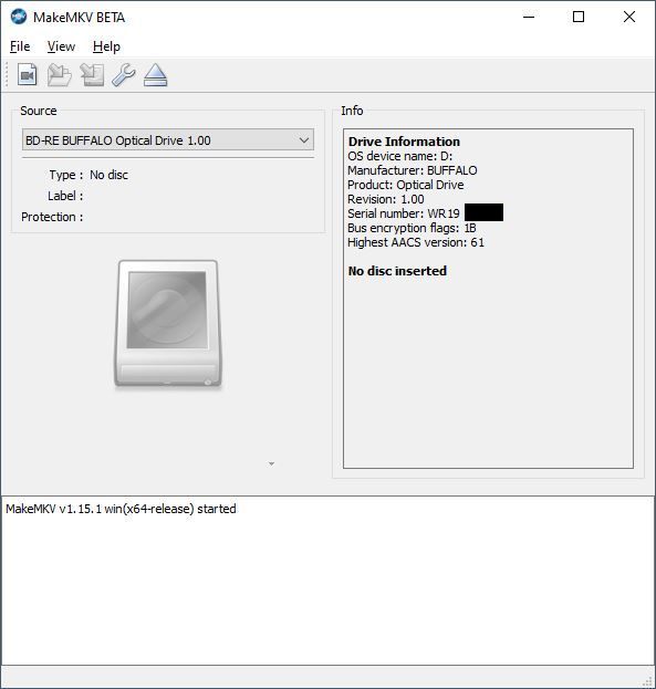

Your drive seems to be flashed successfully. Please post a screen shot of the Makemkv splash screen after startup which lists more information.

You will get better info by makemkv if you just put a regular BluRay disc in the drive. That was the recommendation you got. First things first. UHD will be the next step.

Sadly I've got the exact same Problem as you (I've tried a few more Firmware versions, none worked always Updating Failure #1). I've bought the drive new from Amazon in July 2017, I don't think that i've updated the Drives Firmware. For some reason MakeMKV(v.1.15.2) wont display more Information about the Drive as i saw it doing in other Threads, even with an DVD/ Blu ray Disc inside (Disc Information is shown normally though), with an UHD Blu ray Disc inside it does the same thing as your Drive does. I hope the Information is at least somewhat useful.
OS device name: J:
Current profile: DVD-ROM
Revision: 1.00
Serial number: WR51 8XXXXX
Highest AACS version: 64
I hope someone can help.
