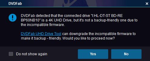

I just re-installed the trial (DVDFab11_x64(11.0.8.7)) that I had downloaded in May. The popup message I am talking about is below.
Ignore the drive model in the pic. I had to connect a drive that has incompatible firmware. Do you not get this popup message anymore? With a drive on NS55 1.04-MK, I just ticked the box and clicked "no".
If this message no longer appears, that sux!!

It doesn't. It links to their downgrade ripo...er software. Just an ok button. No yes/no. No don't show checkbox.
Bugger. I wonder if you can roll back to DVDFab11_x64(11.0.8.7), do the things I did, then update to newer version again?

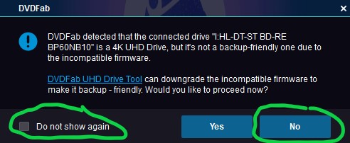

I just downloaded and installed the latest version (11.0.9.6) and got the same popup message. Here you go.
DVDFab latest version message.jpg (27.91 KiB) Viewed 24416 times

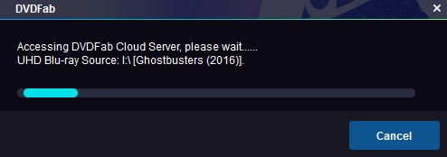

After ticking and clicking "No", I put a disc in and get the below messages. (I know this drive is unsupported, which is the same message I got with ASUS 3.10-MK but for NS55 1.04-MK, I didn't get the last message and I was able to start ripping the UHD disc.)
