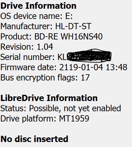

Hi all,
I purchased a new WH16NS40 (drive info attached).
Drive Info.JPG (54.79 KiB) Viewed 28574 times

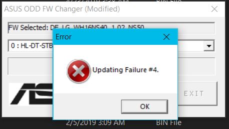

When I tried to flash the DE_LG_WH16NS40_1.02_NS50.bin included in the zip, the drive bay opens up and I get flash error #4.
Flash Error.JPG (26.97 KiB) Viewed 28574 times
Would appreciate any help on what I'm doing wrong and what would be the correct way to flash this drive.

Flash WH16NS60 1.02mk first or keep it if you like
All that info and more in the uhd guide

Thanks for the quick reply! I missed that step first time.
Everything works great now :)
