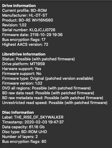

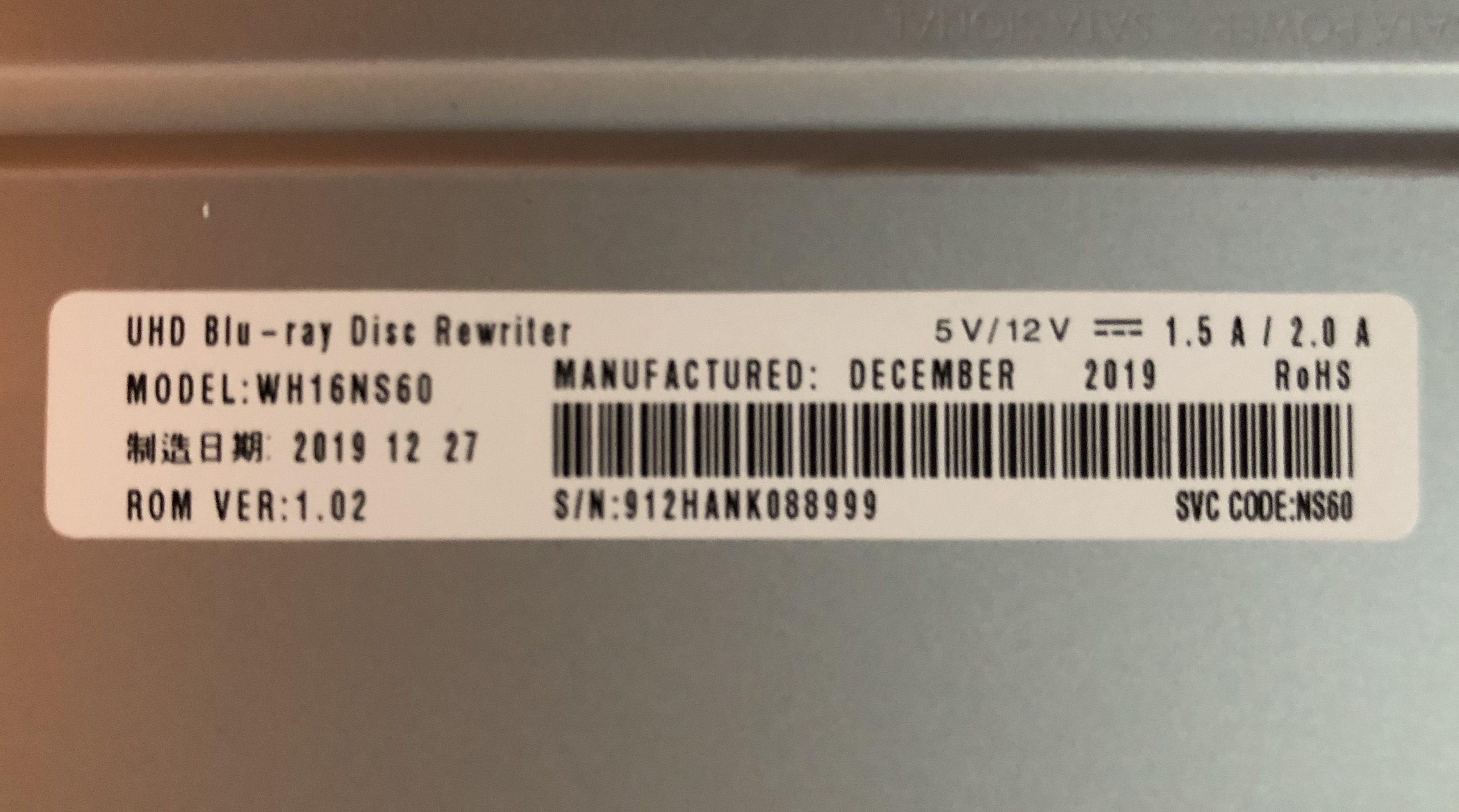

Hi, thank you everyone for this topic. It has mostly made this clear for even a not so tech person like me to understand all of this.
I just want to double check on the current state of this procedure. My WH16NS60 drive was manufactured 12/27/2019 with the 1.02 firmware. MakeMKV says it is a 1.02d - "Optical drive "BD-RE HL-DT-ST BD-RE WH16NS60 1.02d" opened in OS access mode."
Is the patched 1.02 firmware linked to on page 1 "mk-firmware-pack-20191013" still the current firmware to use? All I plan on using this drive for is ripping BD/UHD in MakeMKV on MacOS
Posts: 5799
Re: Step-by-step guide for the best (IMHO) drive: LG WH16NS60
opuscroakus wrote:
Sat May 09, 2020 4:55 am
Yes the d is just from the Mac you should use 1.02mk WH16NS60

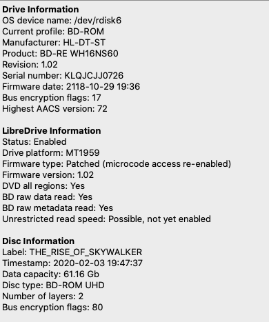

opuscroakus
Joined: Wed Jan 16, 2019 7:28 pm
Post by opuscroakus »
Success!! I patched it and it works like a champ. Just finished ripping The Rise Of Skywalker.
Thanks again for the helpful post!

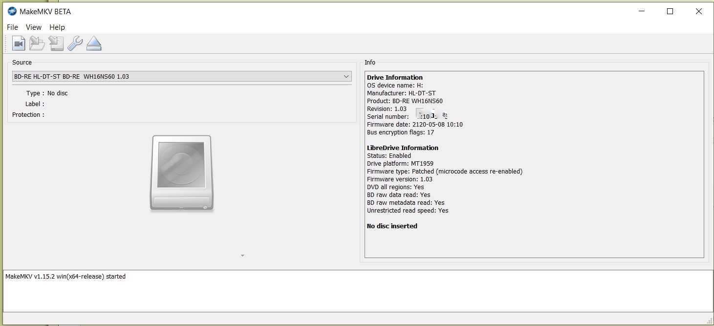

kastaway33
Posts: 11
Joined: Sat Aug 22, 2020 5:11 am
Post by kastaway33 »
Hello, I recently purchased a NS60, looks like it was made end of 2019 with firmware 1.02
Is the firmware 1.02mk allow for UHD rip feature? Also, what is Sleep Bug? Does that require a previous firmware?
kastaway33
Posts: 11
I followed the step-by-step instructions, started with LG WH16NS60 v1.02, I updated with file "HL-DT-ST-BD-RE_WH16NS60-1.03-NM00600-212005081010.bin"
Now my Drive says Libra Drive: Enabled but the version is 1.03 ( attached a screen shot)
I am where or hos do I get file for version 1.02mk to flash?
Thank You for any help.
Edit:
Seems that I may have used the 1.03 version firmware, for WH16NS60 the 1.03 is encrypted? Even if it is the MK version?
What is the advantage of version 1.00 or 1.02 versions?
Much Appreciated
LG drive screen shot v103.jpg (121.19 KiB) Viewed 38847 times
