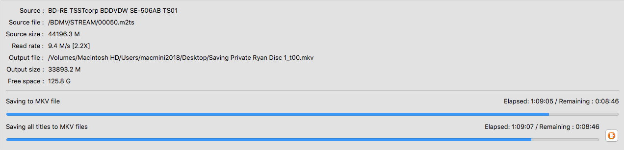

Speed 2.2x, take forever!

Posts: 10928
Re: Optical BD drive that doesn't cap at 2.2x
That is a rather old drive (last firmware update 2012). It's actually kind of fortunate that it is limiting its speed, because it would run in to power issues if it didn't - it cannot sustain full speed on just a single USB power powering it, and it would probably go off-line at about 4-5x speed, mid-rip.

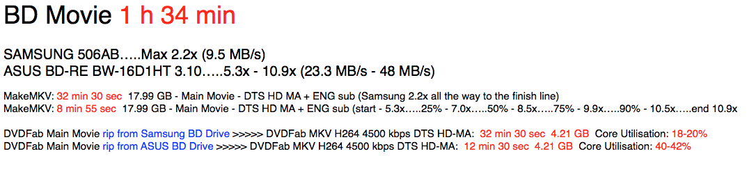

Thanks to jonghotti for this fabulous drive!
Here are some numbers to compare with my old Samsung
