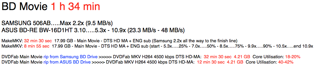

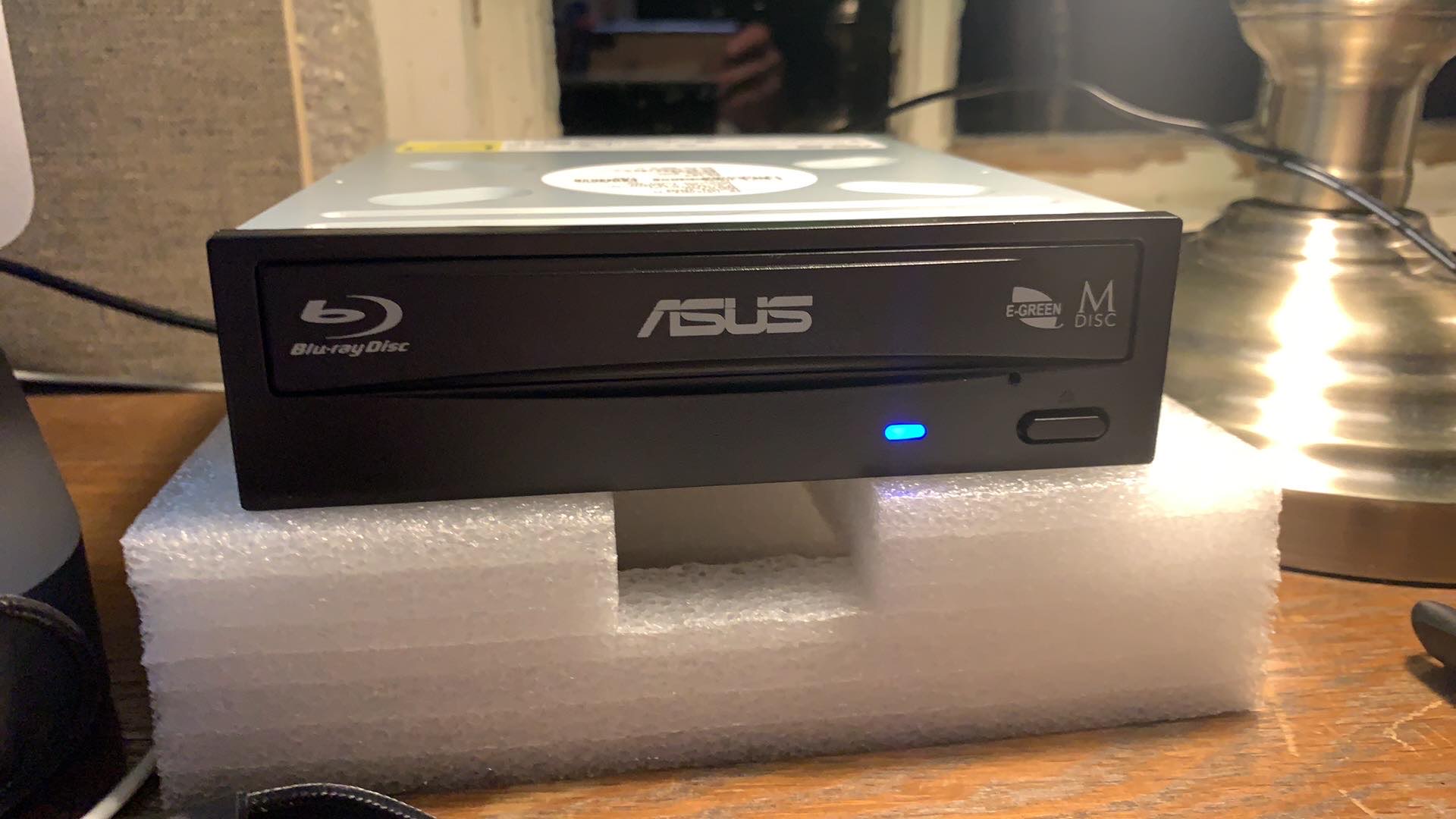

Re: Asus BW-16D1HT Firmware
Thanks to jonghotti for this fabulous drive!
Here are some numbers to compare with my old Samsung
