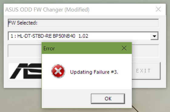

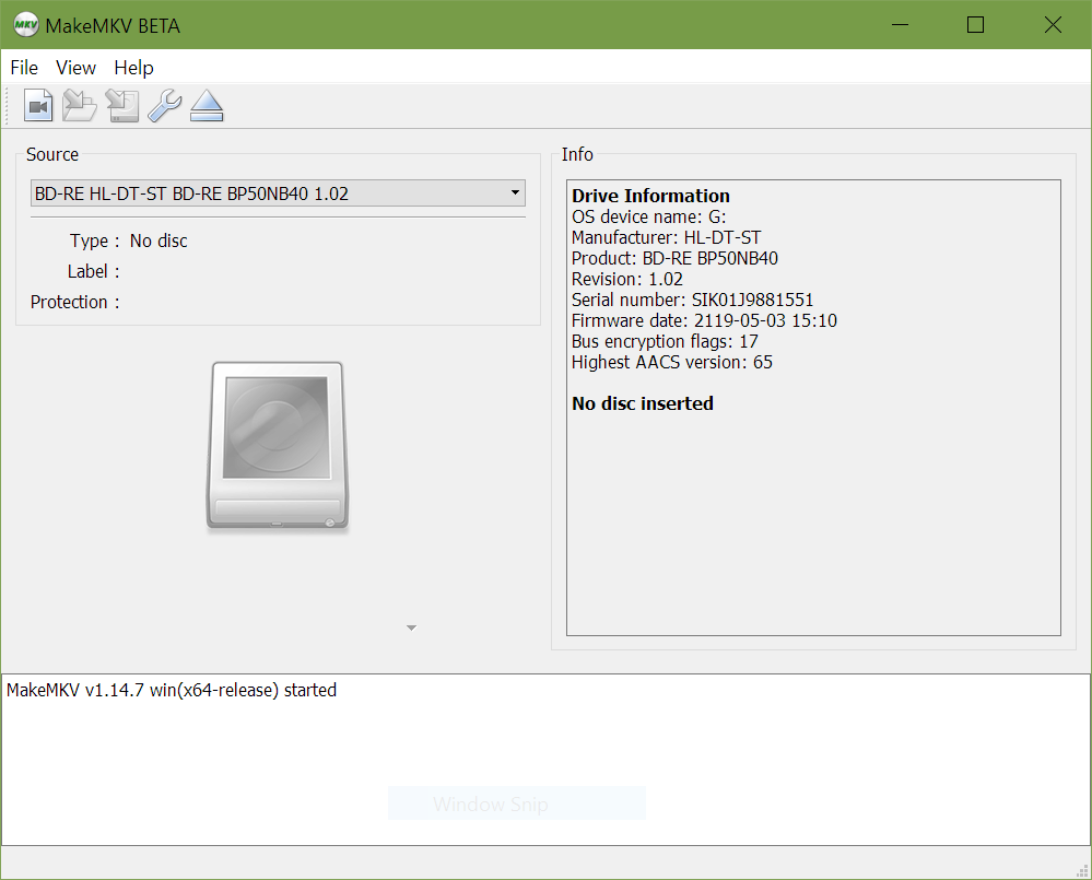

I bought an LG BP50NB40. SVC-NB50, manufactured 2019-09-10, FW 1.02. Goal is to rip UHD discs.
I installed MakeMKV on a Windows 10 machine, installation went fine, sdf_xxxxx.bin is visible in ~/.MakeMKV/_private_data.tar. However, when I open the program, I don't see any LibreDrive info for my drive:
Okay, weird, maybe it'll show up after I flash. I follow all the instructions in Marty's ASUS Flasher thread, and I try to use that tool to flash either the 1.01_MK or Hybrid firmwares. However, neither work -- when I start the flashing process, the drive ejects instantly and the process fails, saying "Failure #3":
Pretty weird. A couple people, in connection to this error, have suggested perhaps a faulty/incompatible drive enclosure -- but this advice doesn't seem relevant to the BP50NB40, which can only be used externally, communicating over USB. There are no SATA cables or drive enclosures; the whole thing is self-contained.
Any ideas?
Thanks.

Re: BP50NB40 not working; "Failure #3"
forresthopkinsa wrote:
Wed Jan 01, 2020 1:02 am
I'll try to make this brief.
Any ideas?
Thanks.
To see the LibreDrive info, please insert a disc.
To rip UHD, First, you need to flash the BP50NB40 1.02 MK firmware from the MK folder. Then you can cross-flash using the hybrid BP60NB10 1.00 firmware.
jinx100
Posts: 178
Post by jinx100 »
If you lack LibreDrive information, then sdf.bin is probably not installed in your data directory. Is the option "allow contacting the server" enabled and do you have an internet connection?

forresthopkinsa
Joined: Tue Dec 31, 2019 6:22 pm
Post by forresthopkinsa »
Okay so I guess this thread is probably going to be a dud, but maybe the solution will be helpful to someone out there.
The problem was a stupid one. It looks like the first time I downloaded the ASUS Flasher, I did it from the MediaFire link, and the .exe must have been corrupted in transit or something. I tried downloading it again, this time from the direct link, and that .exe worked fine.
FWIW here are the checksums:
From the MediaFire link, here's the broken ASUS_ODD_FW_Changer_(Modified).exe MD5:
e83e8c24545da818475ec765479ed696
From the direct link, here's the working ASUS_ODD_FW_Changer_(Modified).exe MD5:
61a8bc642db0c5bca7a12282aad66f7d
Sorry for the waste of time guys, it's all working brilliantly now. I appreciate the support.

orrelljet wrote:
Thu Jan 02, 2020 3:58 am
I'm getting the same error, with the same drive on the same firmware version (1.02).
Any suggestions?
EDIT. Silly question but would this have anything to do with the year on the firmware showing as "2119"?
EDIT 2. Just spotted the drive I've just bought is actually SVC: NB40; am I out of luck?
To enable libredrive, you need to flash the BP50NB40 1.02 MK firmware from the MK folder.
To rip UHD, after flashing 1.02-MK, you can cross-flash using the hybrid BP60NB10 1.00 firmware.
1. No. That is just the way the year is shown.
2. It could still work on the SVC: NB40 so long as MakeMKV shows the drive as "Drive platform: MT1959"
orrelljet
Joined: Thu Jun 16, 2011 3:01 am
Location: Adelaide
Post by orrelljet »
Thu Jan 02, 2020 6:02 am
Bloody genius!!
Worked for me too.
