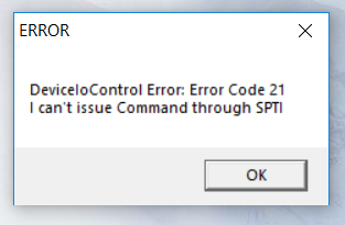

First, thank you so much for creating the Firmware downgrade tool and YT video for Asus BW-16D1HT. Amazing work!
Whenever I run your tool to downgrade, I first get the following error pop up:
Error Text:
"DeviceIoControl Error: Error Code 21
I can't issue Command throug0h SPTI"
<<OK>>
I took a chance (hugh risk) and clicked OK and the usual Firmware Downgrade window showed up next and proceeded with the suggested step. It downgraded the firmware to 3.0.2. However, I wonder why I aways get this error message when I run the program. Pls let me know if you know the reason. Thanks.
The drive is in the Vantec NexStar DX USB 3.0 enclosure connected to Win10 laptop through USB 3.0 port.
- Posts: 4915
Re: Firmware downgrade using official (patched) flasher, the "Ultra hax0r guide"
@nj54567,
I think it has something to do with the Vantec enclosure not wanting to pass all commands through to the drive. I'm pretty sure other people have had a similar issue with Vantec enclosures.
