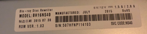

Hi guys,
if I understand you right, my device would not work, because of the wrong service code. Is there any possibility to get this to work?
If not, I would buy an ASUS BW-16D1HT.
Regards Hoppel
OS device name: F:
Product: BD-RE BH16NS40
Revision: 1.03
Serial number: K96F7UF5237
Firmware date: 2115-05-26 17:14:
Highest AACS version: 62Regards Hoppel
- bh16ns40.PNG (151.39 KiB) Viewed 42281 times
TeddyRaspin
- Posts: 202
- Joined: Thu Dec 28, 2017 1:41 pm
Re: UHD drives
NS40 is not UHD friendly, I'm very sorry.

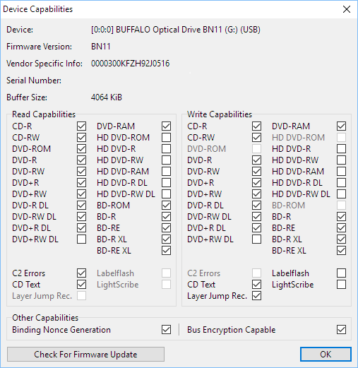

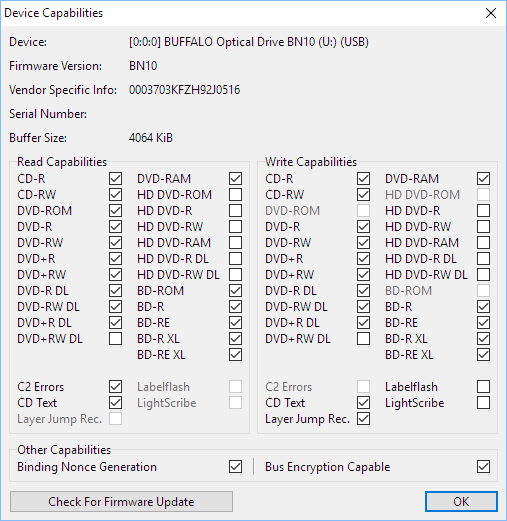

BUFFALO external slim UHD drives
after buying a BRXL-PT6U2VB (manufactured November 2017), I was rather disappointed that the original FW BN10 (Date: 2017-05-30) was incapable of reading UHD blu-rays. Flashing to the latest FW BN11 (Date: 2017-11-20) did not improve a thing. Since the old FW v1.02 ought to be the same for numerous BUFFALO slim drives:
is there any way to force flash this FW Version?
BRUHD-PU3
BRXL-PT6U3
BRXL-PT6U2V
DVSM-PTS58U2
DVSM-PT58U2VRe: UHD drives

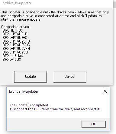

Re: UHD drives
Wow, thanks Teddy for the great guide but it's really 'chinese' to me... This looks way too complicated for me.TeddyRaspin wrote:Because no Asus drive is detected. You have to use the LG crossflash flasher and load the clean firmware.ArieS wrote: I tried to load the Asus 3.02 firmware that I got from Asus website called ASUS ODD FW Updater for BW-16D1HT.exe
But each time I press Start I get a popup saying: There is no target drive.
Am I missing something?
Thanks in advance, people
I've written a specific guide to do that. https://www.makemkv.com/forum2/viewtopi ... 16&t=17058
I was hoping for an .exe and be done with it
TeddyRaspin
- Posts: 202
Re: UHD drives
Try this. Run the exe and select the firmware bin file (ASUS 3.02).
- Flasher.zip
- (2.96 MiB) Downloaded 1466 times
Re: UHD drives
Thank you Teddy!
The update went smoothly. Very appreciated and thank you for taking the time!
Even though it still cannot read Oblivion
at least I have the last firmware which I've read helps my drive with speed...
