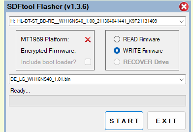

Hello Goodmorning,
I have tried to flash by LG Internal BD Re writer WH16NS40 1.00 K9F21131409
but getting error message "the drive you have selected does not have the correct platform (MT1959) and cannot be flashed
i have tried with stand alone file "DE_LG_WH16NS40_1.01.bin.zip" but still getting same error messsage
i have attached screenshot

From the flashing guide :
1. Make sure your Drive was built after 2016 on label or late 2015 if you want to risk it.
2. Drive Platform MT1959<Most important in makemkv
3. SVC NS50+ LG only on label for NB drives NB50+
4. Just because your drive is the same model number does not mean it will work, if you are unsure ask me i offer remote flashing and check everything before i flash.
5. Dont flash your dive if it does not meet these requirements if you do you will be unable to read all disks and unable to restore without dosflash that does not work on most modern computers
The screenshot you posted shows that your drive platform is MT1939. I believe you most certainly shouldn't attempt to flash it.
Next time you attempt to flash an LG drive, please be sure to read *all* of Billycar11's guide, not just the first post in the SDFtool Flasher thread :wink: : viewtopic.php?f=16&t=19634
If someday you should get another LG WH16NS40, one that's actually "flashable" (because seriously, do *not* attempt to flash your current drive), I should point out that this wasn't even the correct firmware file, as far as I know. Again, please see Billy's guide above.

This drive is too old (pre 2016) and has the old, incompatible MT1939 drive platform. It can never be flashed nor be made UHD capable. Don't even try, you WILL brick it!!
SDFtool flasher did it's job and advised you that it is the wrong drive platform and cannot be flashed.

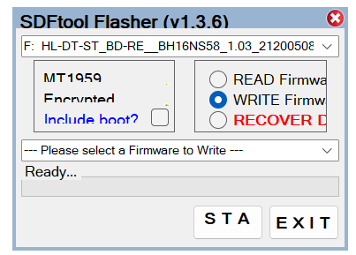

Thank you Marty for all your help here! I have downloaded the SDFtool Flasher v1.3.6, but it isn't displaying correctly, so I'm not sure if I should try to proceed with flashing my BH16NS58 (inside Buffalo enclosure). Here's what I see... I can't see the green checkmarks. Hopefully it's OK? I previously had text scaling at 150% in Windows 11, but I put it back to default after seeing this problem, but it didn't make a difference. Sorry, I would have sent this to you in a private message, but I'm a new member and I don't see any link/button.
EDIT: I found the answer after I re-read the instructions in the first post. Sorry, my bad!
"NOTE: If the GUI looks a bit deformed (happens on a 4k monitor), you can right click the exe and select properties. In the compatibility tab, click "Change high DPI settings" then under "High DPI scaling override" tick the box and select "System (Enhanced)" in the dropbox."
