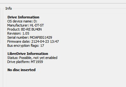

Can BU40N (HL-DT-ST_BD-RE_BU40N_1.05) be firmware flashed with mk1.03, when the revision on Verbatim drive is 1.05?
From what i understand by reading the guide, is that there are no reason to flash it several times or make a backup of the current firmware, you just flash the DE_LG_BU40N_1.03_MK.bin firmware and that's it? With mk-firmware-pack-20200720 in the sdftool, i find many BY40N firmwares, but which to chose from? is this the correct one? HL-DT-ST-BD-RE_BU40N-1.04-NM00500-212005061142.bin?

babayaga
Posts: 39
Joined: Fri Mar 06, 2026 11:02 pm
Post by babayaga »
babayaga wrote:
Sat Apr 18, 2026 3:28 pm
So the trick was to only flash DE_LG_BU40N_1.03_MK.bin and everything worked, no more no less, it's a bit hard to understand sometimes in this forum, what you should actually do, and the guide can be a bit misleading i think. And what about the HL-DT-ST-BD-RE_BU40N-1.04-NM00500-212005061142.bin that is included with the flasher? is this a newer iteration of the 1.03MK firmware or just a original 1.04 firmware?

Post by tomty89 »
babayaga wrote:
Sat Apr 18, 2026 6:56 pm
Files in the MK firmware pack are all MK firmware. An MK firmware is just an original firmware of the same version number that has been patched in some way, so when there is a more updated original firmware, there's a chance that mike could patch it and update the pack.
(Note really sure what DE_LG_BU40N_1.03_MK.bin is.)
... If your drive has one of these firmwares, and there is no MK version of the same firmware/drive model or higher number, you will have to sidegrade to ... or (BU40N 1.03MK LG Slim drives ONLY) ...
But I have to admit that I'm also not sure whether there's something "special" about HL-DT-ST-BD-RE_BU40N-1.03-NM00000-211810241934.bin, or if it's just that "The all you need firmware pack" and the guide didn't catch up with it when the MK firmware pack got updated...
P.S. The thing is being more updated does not necessarily means the firmware is better, especially when it comes to UHD capability / ripping compatibility / ... (what people here mainly concern). Also maybe whoever maintains the guide / all you need pack follows the "not broken don't fix it" policy (while mike just tried his best in MK-ising the relevant original firmware when new versions showed up).
