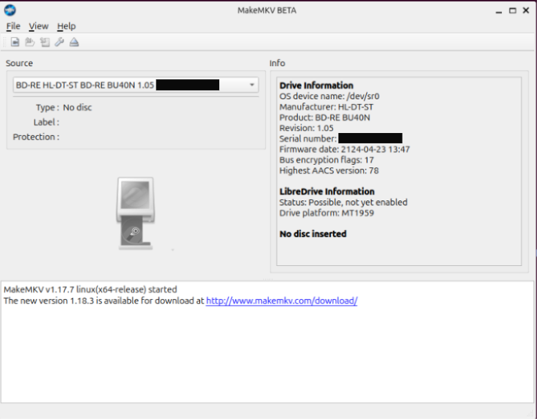

I've buyed a Verbatim 43888 UHD Drive to digitalize my movie collection, but have general problems ripping UHD discs.
First of all it's a drive with an LG BU40N on firmware v1.05, ripping movies out of the box wasn't possible (surprise surprise).
So i flashed it with the help of the flashing guide in this forum down to firmware v1.03.
I'd used this command to flash it on makemkv v1.17.7 on my linux system:
makemkvcon f -d /dev/sr0 -f /tmp/sdf.bin rawflash main -i /tmp/HL-DT-ST-BD-RE_BU40N-1.03-NM00000-211810241934.bin
Afterwards with launching makemkv i still get the info, that the drive is on firmware v1.05, but normal blurays and dvds can be ripped now.
Screenshot from 2026-03-14 12-27-25-edited.png (131.9 KiB) Viewed 2367 times
And the LibreDrive Info states "Possible, not jet enabled" (I unfortunately don't have a screenshot before flashing).

Posts: 4526
Re: Verbatim 43888 not ripping UHD movies
Use enc instead of main in your command line.
droman1995
Joined: Sat Mar 14, 2026 10:17 am
Post by droman1995 »
Thanks for the help. Now it looks better (v1.03 displayed and UHD discs are working now too).
