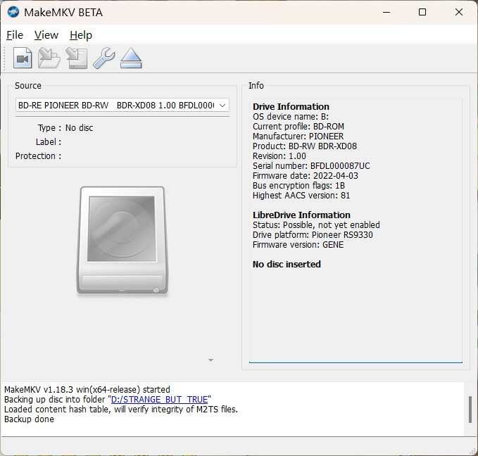

Hi I was researching how to get my drive to read UHD disks and was wondering what I can do to make this happen, thank you. Here is my drive info on makemkv:
Posts: 5617
Re: Pioneer BDR-XD08B
munch13s wrote:
Sun Mar 08, 2026 4:24 pm
Sure email me that drive info section see below for email
For all others there is no need to post your makemkv drive info section publicly just email it to me directly
