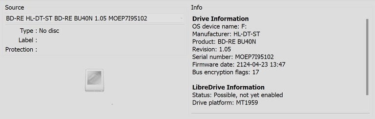

Username:0000
Joined: Wed Dec 24, 2025 2:04 pm
Re: SDFtool Flasher
Post by Username:0000 »
Hi
Here are the details for my Verbatim Blu-Ray drive please see attachment.
I have downloaded and ran the SDFtool Flasher.exe, were do I get the firmware that will be flashed by the SDFtool? that is shown in the list of forum in the gif?
Posts: 1716
Re: SDFtool Flasher
Post by d00zah »
Username:0000 wrote: Sun Dec 28, 2025 1:56 pm ...
Same place you downloaded the SDFtool Flasher... linked in 1st post of the SDFtool Flasher topic.
Here is the link to my "All You Need Firmware Pack"
https://www.mediafire.com/file/bpl3pz2b ... 9.zip/file

Username:0000
Re: SDFtool Flasher
Username:0000 wrote: Sun Dec 28, 2025 1:56 pm Hi
It worked, thanks for the assistance.
OS device name: F:
Product: BD-RE BU40N
Revision: 1.03
Serial number: MOEP7I95102
Firmware version: 1.03
