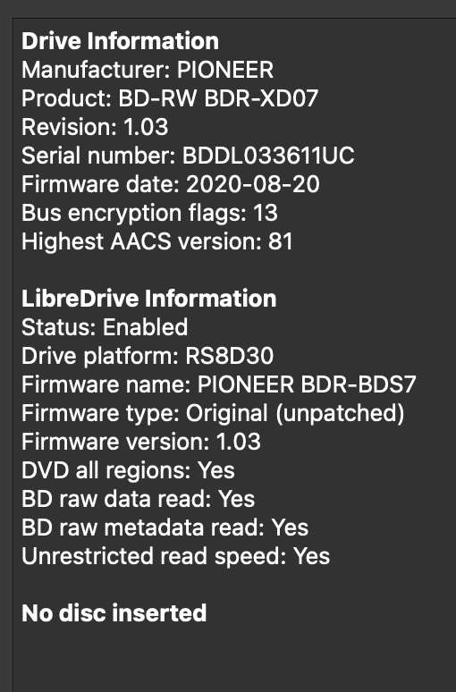

I need to rip a 4K Ultra HD Blu Ray. I've used MakeMKV in the past before and had no issues (including this morning, just ripping a Blu Ray) but whenever I put in the UHD, the disk spins for a bit and then MakeMKV reports there is not disc. I have already tried cleaning the disc and trying it in another Blu-Ray player, which worked, so I don't think it's an issue with the disc.
While reading the forums, it seems I need to flash the firmware I'm using? There were a few forums where I needed to contact someone for a download, and I'm not sure who the best person for that is.
I attached my specs, also using a Mac running Monterey 12.4
Any help is appreciated, thanks!
Screen Shot 2025-12-18 at 12.29.45 PM.png (101.46 KiB) Viewed 1782 times

That is because your drive is not UHD compatible! It must be a UHD model or be cross-flashed to a UHD model. Email Billycar11 and he can help you flash it.

PM sent.
