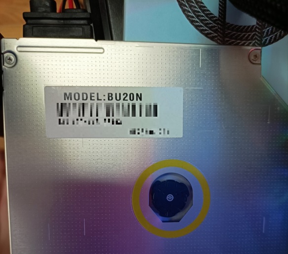

Re: Possibly bricked my drive (BP50NB40, SVC-NB40)
I have a backup of firmware and this maybe solves your problem. when I disassembled my BP50NB40 external case, I found that there was a model labeled BU20N.
I checked that the BU20N firmware is also available. but the BU20N models are not yet UHD friendly even if they have a mt1959 chip.
If you are not sure if this firmware is correct, open the external case and check

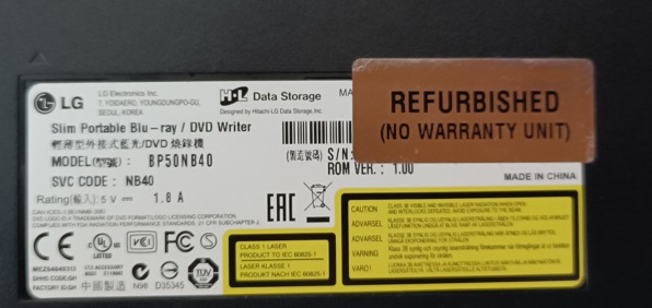

Hi All,
Sorry to resurrect this thread but I seem to have hit the same issue, there was a label on my drive and I did not spot the SVC Code as NB40
I have the same issue of the fact the drive will not now open and appears to be a BU20N inside so I may just be out of luck
The only difference I have is that MakeMKV can see the drive and so can the SDFTool, I did try and restore the firmware dump I did before but not luck with that tool. If there is another I am willing to try! Just a shame as the drive worked perfectly apart from 4K
Hi all, I know this is a old thread, but for others coming here because of a 'bricked' BP50NB40 SVC CODE: NB40 ROM VER: 1.00, due to flashing an incompatible firmware (like what I did!) and the drive does not eject, I tried a couple of things and in the end using the original firmware posted above works!
I used SDFtool Flasher v1.3.6.
As mentioned by others, you need to use the RECOVERY option, and for this to work, you need to select the current firmware when the first pop-up file explorer appears. Then in the normal dropdown, I selected the 'BP50NB40-NB40-1.00-N016602-211409031732.bin' file. According to the Marty, this is so that the boot ID can be obtained. If the flashing finishes very quick (less than 5 seconds), the flashing was not successful.
If the above does not work, then try flashing to another wrong firmware using WRITE first, e.g. use the BP50NB40-NB50-1.03MK firmware, then RECOVERY and selecting the same BP50NB40-NB50-1.03MK firmware in the first popup. Then in the normal dropdown, select the BP50NB40-NB40-1.00-N016602-211409031732.bin' file. (Tried a few different combos, and I cannot remember exactly the steps, sorry... I thought is a was a lost cause, and was just trying my luck.)
In the end, I reverted to the 'working' firmware, and now the drive can eject and has reverted back to the original firmware. I was really planning to throw the bricked drive away. Good luck to any one else having the same issue.

flscans!! another thank you!! can confirm this fixed another bricked BP50NB40 SVC-NB40! had flashed the 1.03mk firmware before realizing my drive wasn't new enough (SVC-NB40)
clarification / verification of exact steps needed:
1. use sdftool and write the current bad firmware (the 1.03mk for me)
2. unplug drive and plug back in
3. use sdftool again, select drive first in drop down.
3a then select Recover option. as flscans mentioned, the first prompt will be the firmware you just wrote. then after that click the bottom drop down to then choose the original firmware posted above (the BP50NB40-NB40-1.00-N016602-211409031732.bin file). and then click Start.
4. it takes a few minutes and will linger on the full progress bar (my prev attempts went really fast and didn't do anything). once it comes back to the normal window, i gave my drive a minute or two. check explorer (without even powering cycling) and bam!! my bluray movie shows up!!
YOU ROCK! there were so many unclear posts about this. hopefully my additional notes will clear it up for others like us.
model info of my drive: BP50NB40 SVC: NB40, build date: 2015
