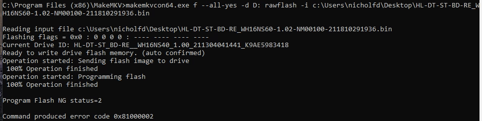

I thought I would be able to flash it to read UHD discs & tried with this:
C:\Program Files (x86)\MakeMKV\makemkvcon64.exe f --all-yes -d E: rawflash -i c:\Users\nicholfd\Desktop\HL-DT-ST-BD-RE_WH16NS60-1.02-NM00100-211810291936. bin
No drive tool logic found in SDF.bin
Internal error 0x8d000000
-------- PROGRESS --------
Wrong drive letter in the flash command (I know - details matter). Tried again. Did something, but eventually failed (after long delay):
Drive Flash Failure.png (173.52 KiB) Viewed 884 times
Shutdown, removed power, reapplied power & turned back on. MakeMKV now shows:
Drive Info After Failed Flash.png (29.13 KiB) Viewed 884 times
Have I FUBAR'd this drive? I still have the 2nd one...

Thanks - too late. I found an issue & tried again. Thought I made progress. I updated my original message before you posted this one or they crossed. Is it hosed?
dead unless you have a pc with sata ide mode and a 32bit os
see recovery section in guide
i no longer give out kits for these was way to much trouble as know one tells the truth about their pcs

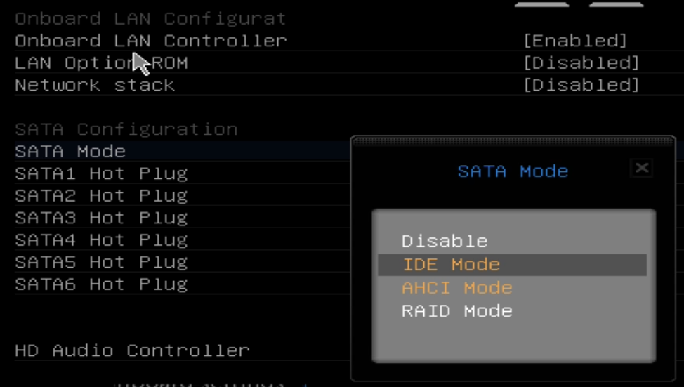

nicholfd
Posts: 65
Post by nicholfd »
Motherboard supports IDE mode
MB BIOS.png (113.95 KiB) Viewed 850 times
Windows 10 x86 (32-bit) installed, with BIOS set to SATA IDE mode.
Win 10 Info.png (9.65 KiB) Viewed 836 times

Posts: 4697
nicholfd wrote:
Fri May 09, 2025 2:13 am
follow the recovery section and my dosflash video do the recovery stuff first make sure to do the steps exactly or dos flash wont work
as i said i dont do kits for this anymore more time than its worth everything you need is in the guide and my old dosflash video from 2019
