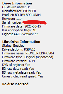

I have Verbatim 43888 with Pioneer UD04. this is makemkv shows me.
Screenshot 2025-04-18 213048.png (12.58 KiB) Viewed 4511 times
but to my problem. basically it just doesn't show me Blu Rays, just regular ones don't have and uhd ones. Makemkv shows "no disc inserted". Except out of like 10 discs and probably over 50 tries i got them to connect twice.

I tried cleaning it a bit. i think it improved maybe a bit. I did some more testing afterwards. but out of the 9 discs i tried, about 3-5 times each. only 4 picked up sometimes. 1 only picked up once.1 got picked up maybe 40% of the time. and a bit of a gamble and 5 just didn't pick up in any of the times i tried them. so it's probably just an issue with the player.
