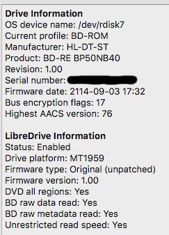

Screen Shot 2022-12-03 at 12.21.36 PM.png (41.46 KiB) Viewed 40103 times
It worked!
Thanks again for helping me restore my drive.
I tried forcing the drive to read UHD discs when it was too old to do so. Oh well another backup DVD, BluRay drive.
Thanks again

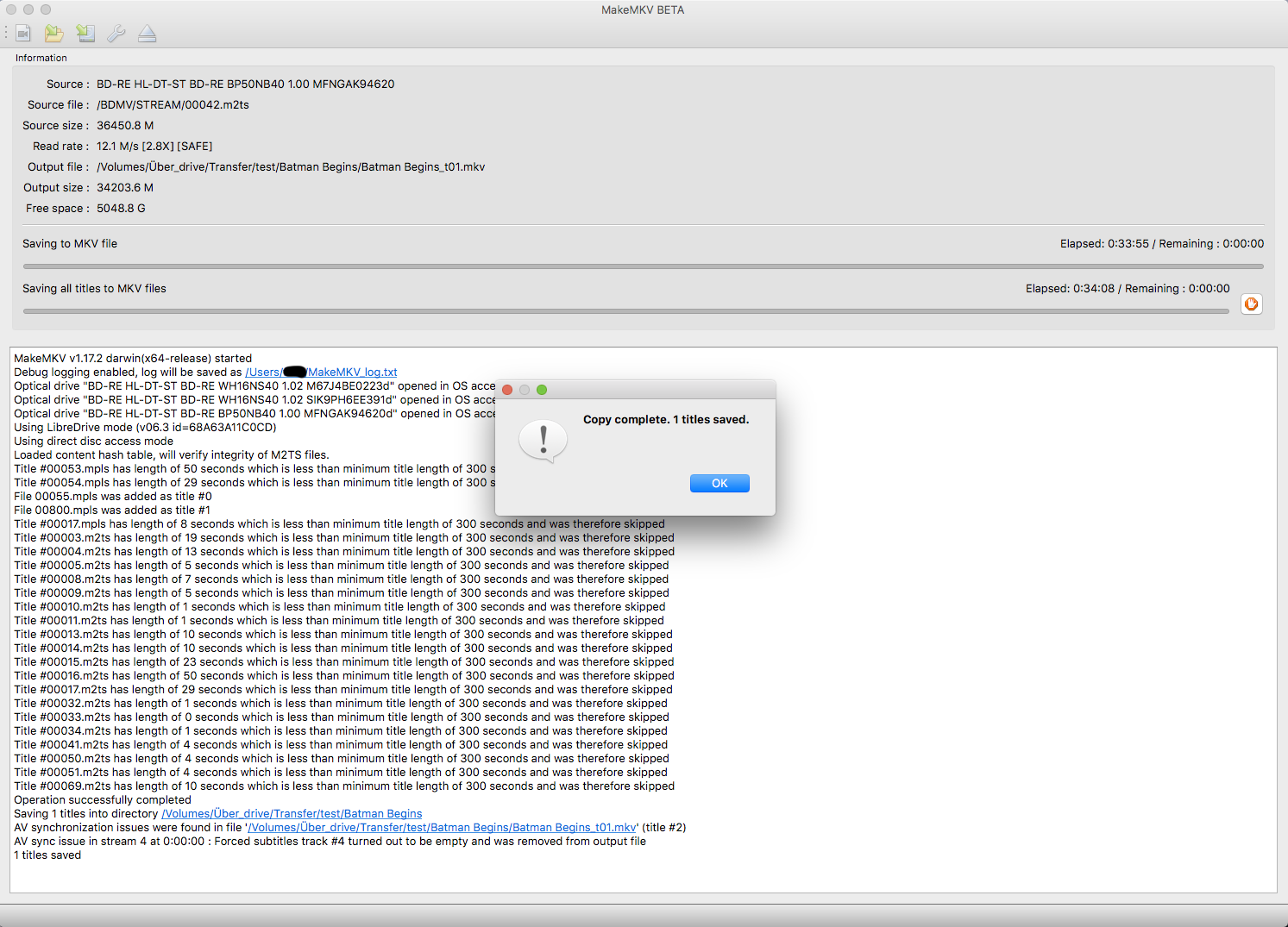

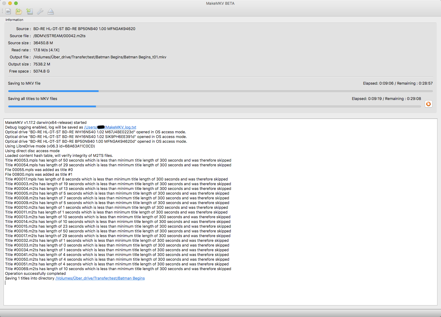

To test the drive, I ripped Batman Begins (BluRay) for a test and it is working OK.
Thanks again for the help
