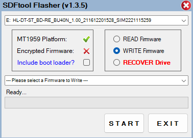

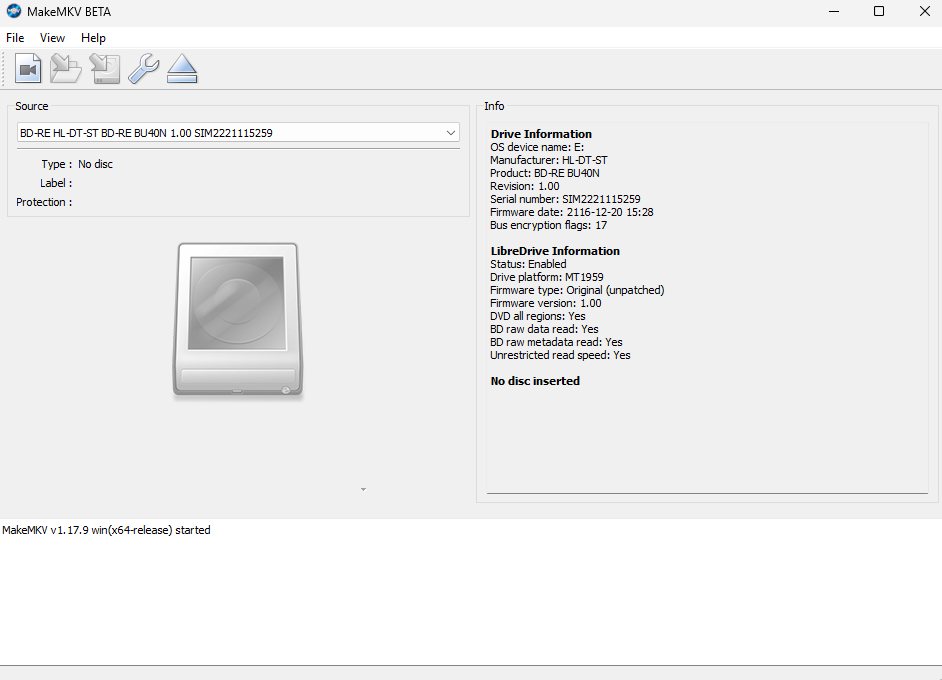

Bought a Lg NB50NB40 NB52 today and tried to go through the process of flashing it. I believe I messed up along the way because it is endless loading the disc in MakeMKV. If someone would be willing to help me out or just at least confirm my fears that I messed it up I would really appreciate it.

Nope, it appears to be flashed correctly.dugtrain wrote: ↑Mon Feb 03, 2025 12:31 amBought a Lg NB50NB40 NB52 today and tried to go through the process of flashing it. I believe I messed up along the way because it is endless loading the disc in MakeMKV. If someone would be willing to help me out or just at least confirm my fears that I messed it up I would really appreciate it.
Did you try cleaning the troublesome disc? Also, let windows initialize the disc before opening MakeMKV.
