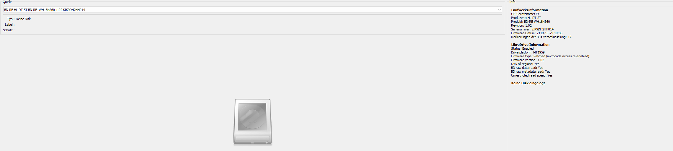

I have LG WH16NS60. I want to flash the 1.02 MK on it.
I have issues with sdf Tool. When I read Firmware it creates an empty folder.
When I want to write simply nothing is happening.
What I'm doing wrong? Can somebody help me pls?
Screenshot 2024-10-29 154501.png (39.91 KiB) Viewed 8406 times
