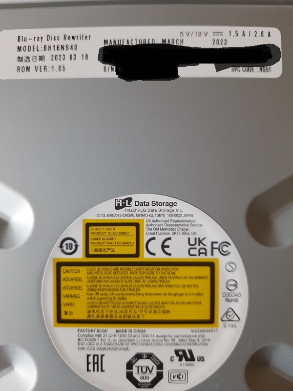

Greetings!
Due to my limited knowledge of the English language, I am not sure whether I can modify this player. (see photo)
Can you give me some advice, thanks.
