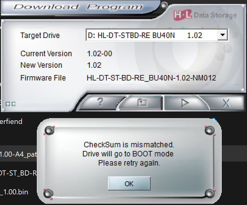

Thanks Marty! I added the ENC indicator but now its failing before its done sending the firmware.
C:\Program Files (x86)\MakeMKV>makemkvcon64.exe f --all-yes -d D: rawflash enc -i "HL-DT-ST-BD-RE_BU40N-1.02-NM01201-211711301218.bin"
Reading input file HL-DT-ST-BD-RE_BU40N-1.02-NM01201-211711301218.bin
Current Drive ID: HL-DT-ST_BD-RE_BU40N_1.02_212012011716_MO8M2QI0627
  98% .................................................
Write DRAM NG 05/26/03
Command produced error code 0x82052603

seen that before either its a whatever error or the case is bad and it cant be flashed through it, recheck your drive info in makemkv see if it flashed it likely did happens alot with amd usb drivers

No luck still shows unpatched in makemkv. Does that mean this drive wont work with uhd for makemkv?

Your not using 1.03 like the guide says missed that the first time :roll:

BU40N 1.03 is in the OLD folder of the firmware pack.

That did it! Thank you!!
