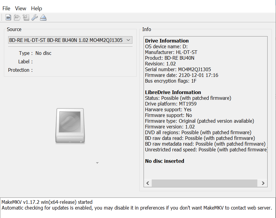

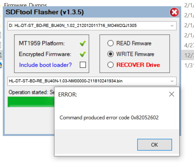

Hi all,
Thanks for this tool. However I'm facing an issue while trying to flash my drive.
I have bought an Archgon Slim UHD drive (MD-8107-U3).
I can't get the drive being flashed and always get the same error as you can see in the attachment.
I post the drive info and the error. You can see the options I have used and the firmware.
Same error whatever the status of encrypted box is.
I tried from the tool with a GUI on Windows and from a Mac using command line, same behavior, it fails.
Thanks in advance for your help

- Posts: 4921
Re: SDFtool Flasher
Never seen that error code before. Make sure there's no disc in the drive and the tray is closed. Also make sure that all USB Plugs are connected so that the drive is getting enough power.crapulas wrote: Wed Feb 01, 2023 10:59 am Hi all,

Re: SDFtool Flasher
I tried it being connected to USB-C port on my laptop and with both USB A connectors (2). I get the same error. It seems the firmware is sent to the device but it stops with this error.
I get the same using command-line on MacOS.
Tray is closed and no-disc in the drive.

Re: SDFtool Flasher
I've seen similar issues and it seems it's the fault of the USB->SATA chip of the enclosure. The Makemkv GUI version has some fixes for those but not the command line version which is invoked by SDFToolFlasher. So pretty much the only chance is to remove the drive from the enclosure and use a) a good USB->SATA adapter or even better b) connect it directly to SATA of a PC.
