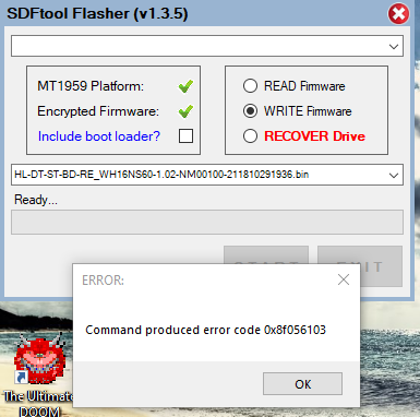

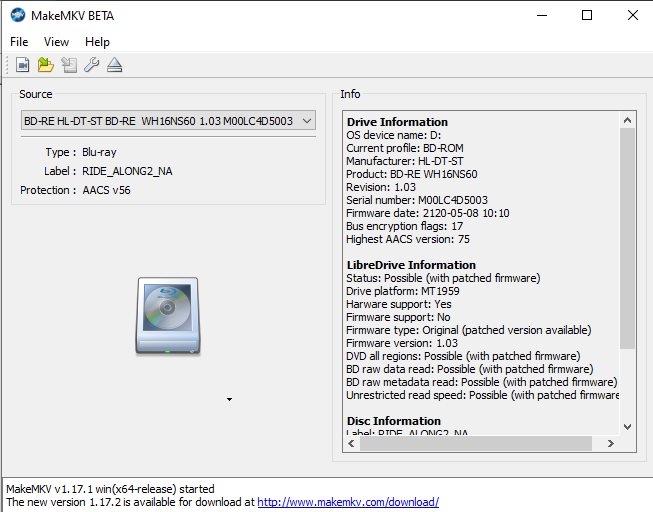

Hello Billy, Thanks for making this flashing tool.
I was having some issues with flashing my drive. I have an LG WH16NNS60 with the encrypted (I guess? The dump matches one of the ones in the encrypted list and the flasher autoflags it) firmware 1.03. The drive is mounted internally in my case with a seta cable. I have tried flashing the 1.02-MK and another random 1.03 (I'm assuming it was "-MK" since I downloaded it from an older thread) firmware, but I get the same error every time, and the drive information in MakeMKV doesn't change.
Please see pictures below. I followed all the instructions, and searched for other users with this exact issue and couldn't find anything similar. So I made this account to hopefully get help resolving this issue. I purchased this drive around a year ago and it works find for regular blurays, but this is my first time trying to flash the firmware.
Thanks.

hopefullythisworks wrote:
Tue Jan 31, 2023 6:41 am
Thanks.
Googling your error code (the memory 0x code) I came across this post viewtopic.php?t=23587
Indicating from a few users that the error was caused by having a disc in the drive. Is that the case in your situation?
