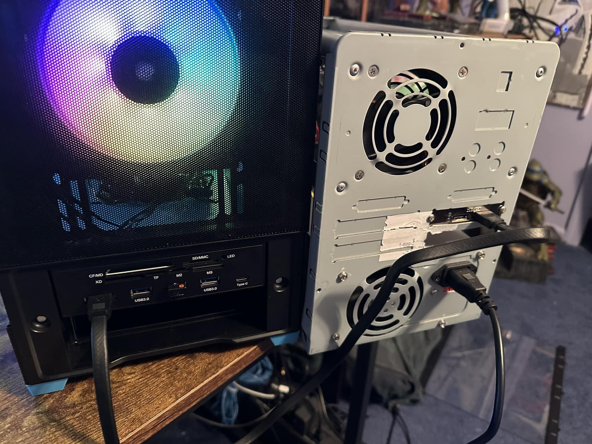

The Disc Copier is in hand. waiting for the e sata card tommorow, and hoping to test it out
thankfully, recovering the movies took far less time than I thought.t 100 4k discs and about 100 blu rays in 2 (?) weeks, with two drives. not bad.
also, with this, next time I get a new computer case, I won't ned a 5.25 inch bay anymore.
Re: just lost entire tv/movie library, questions..
hmm, hooking it up too my card reader e sata does not'ing.
Ordering a PCI port to see if that gets this sucker working.
