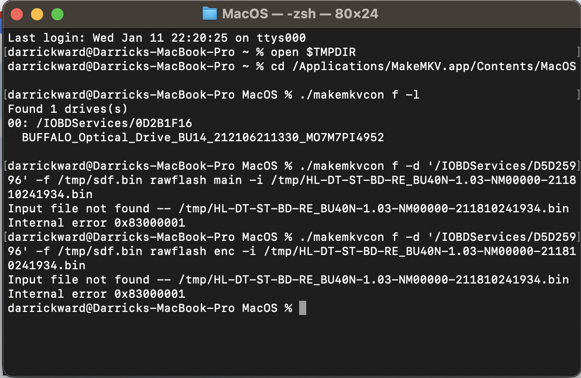

I purchased a Buffalo BRUHD-PU3-BK Drive for ripping UHDs, since that was the top external drive listed. I attempted to Flash my Drive by following the instructions on the "How To Flash Videos and commands" for Mac users, on page 1. My attempt to Flash my Drive has been unsuccessful, and I will post a picture of that attempt here.
I am not sure if I am doing anything wrong, as I am following the guide to the best of my abilities, so I figured I would ask my question here.
- Screenshot 2023-01-11 at 10.54.40 PM.png (382.95 KiB) Viewed 22225 times
Your identifier for your optical drive is /IOBDServies/0D2B1F16 as listed by the first command. The drive identifier you used in the second command is different. In the second command you need to use the identifier discovered in the first command.
