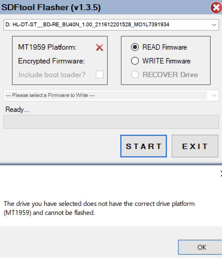

Unfortunately, the Redfox forum could not help. The suggestion was (again) to try and flash my drive. This, however, is not possible (see screenshot).
And, as stated before, MakeMKV states that LibreDrive is enabled. Any idea what I could try to do?
Forgot to mention: the error message cannot be correct since MakeMKV (see earlier screenshot) states that the platform is MT 1959.

You should do what Billycar11 suggested above and load an UHD. Make sure that internet access is allowed. I guess the newest SDF.bin is missing. It will be downloaded when you insert an UHD. Then try again.
BTW- You most likely don't have to flash your drive. But just run SDFToolFlasher if it behaves now OK. Then try if AnyDVD works now also.

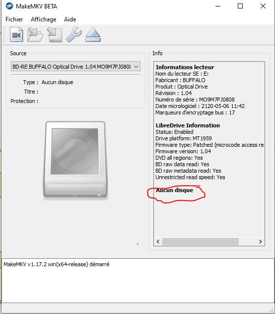

Hi everyone,
I have a Buffalo BRUHD-PU3-BK on witch I have updated the firmware with SDFTool 1.3.5 to HL-DT-ST-BD-RE_BU40N-1.04-NM00500-212005061142.bin.
When I open MakeMKV and I insert a BR, I have: => The drive does not run the BR (seems that the disk is not turning inside) and MakeMkv tells that no disk is inserted.
For information, I have tryied also with these MK firmwares and the result is the same:
HL-DT-ST-BD-RE_BU40N-BN12-0M01001-211905141415 (I suppose my Buffalo is a Japan version as it's written in this language on the box)
HL-DT-ST-BD-RE_BU40N-1.03-NM00000-211810241934.bin (it's the old version of 1.04)
I have also tried with a the DE version: DE_Buffalo_BRUHD-PU3_BU10.bin
This one seems to have worked 1 time, but seems it does not work anymore.
Thank you in advance for your help.

Might be silly but do you have both USB Plugs connected to your PC?Shaka wrote: Mon Jan 23, 2023 1:40 pm Hi everyone,
Did you power cycle the drive after flashing?
Also, don't open MakeMKV until after the disc has been initialised by the OS.

Both USB Plugs must be used as 1 generally provides data and the other ensures the drive receives enough power. Usually a disc won't be able to be read or will cut out during reading if the drive isn't getting enough power. If using a laptop you may need a powered hub as sometimes the laptops USB ports don't put out enough power.

It still sounds like the drive isn't getting enough power. Make sure you are using USB 3.0 ports (not USB 2.0).
Please show us what MakeMKV says on the right hand side.
