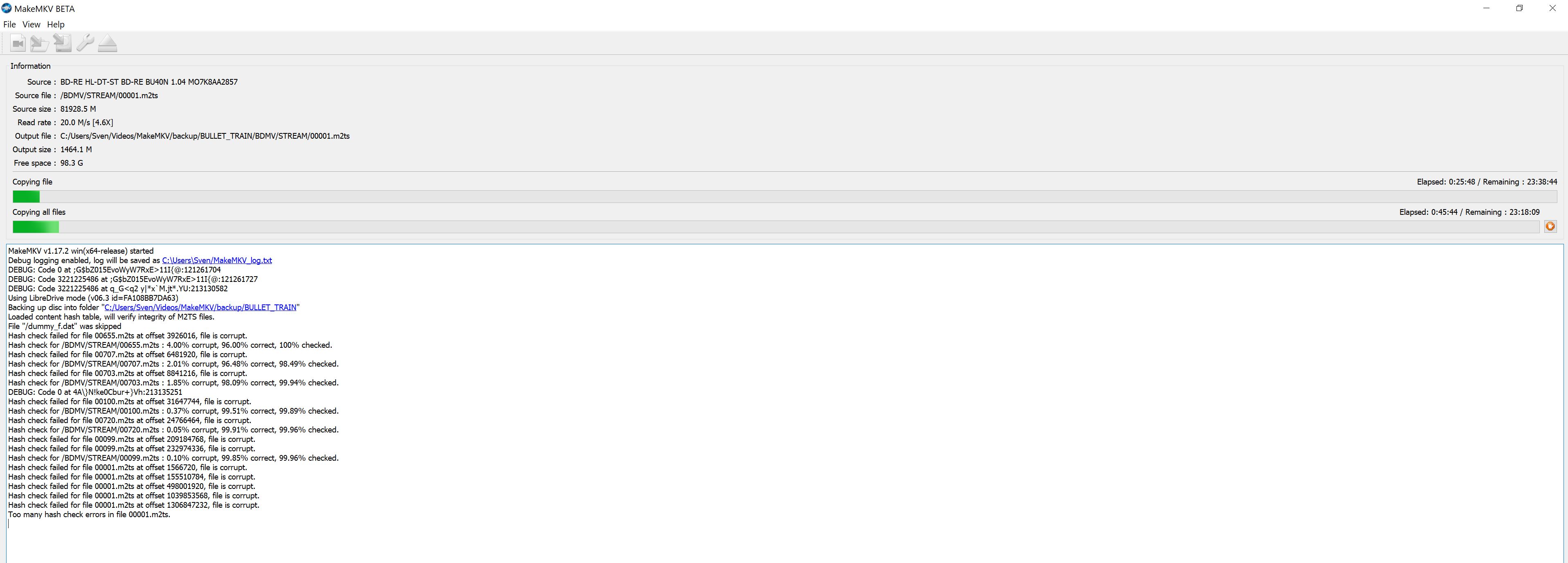

I don't want to kill the backup process to early, but it seems not like the normal behaviour, is it? See image attached. 23 hours remaining...

Posts: 5559
Re: BD-RE BU40N (LibreDrive 1.04 or lower) stopping reading processes on UHD or BluRay
zappes01 wrote:
Mon Oct 31, 2022 3:23 pm
It stopped by itself again. Log file attached.
I would try a new disc at this point as there looks to be no power errors in your log
Posts: 4466
