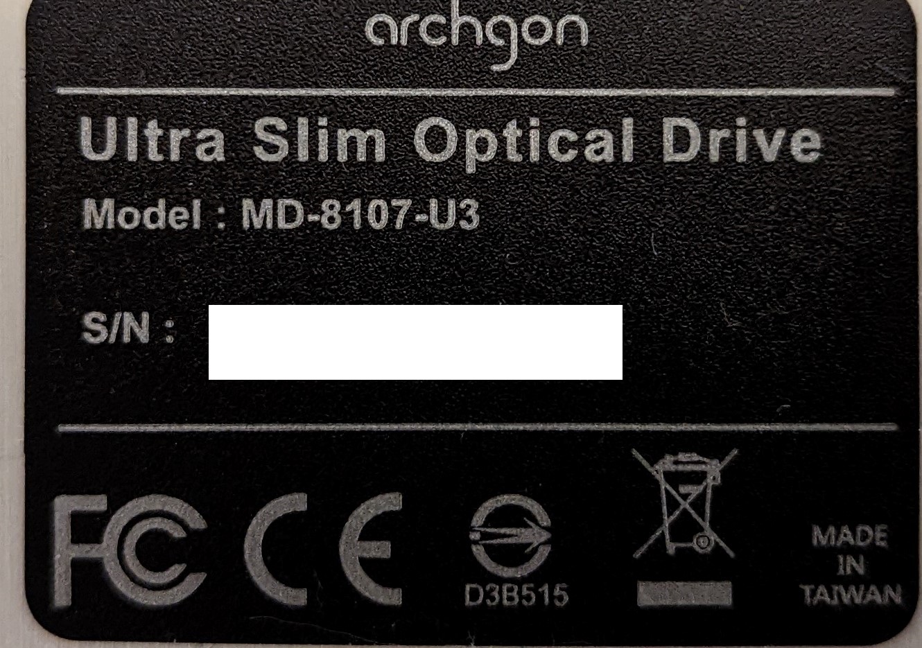

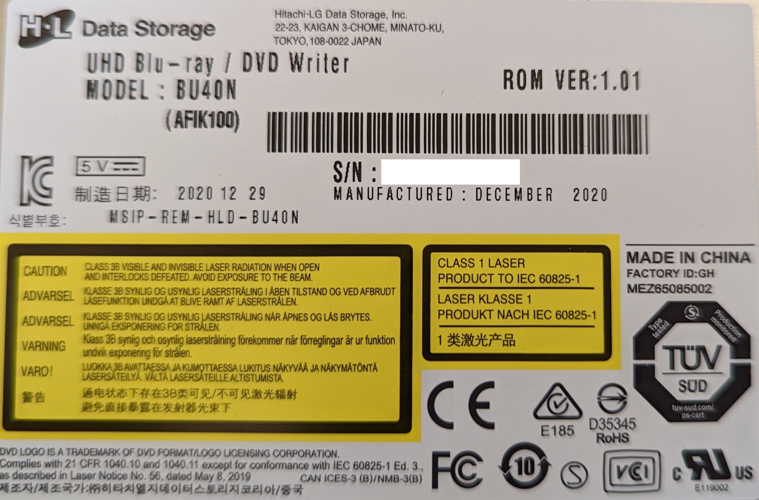

Drive Info:
archgon info
archgon info
Archgon Info_small.jpg (498.99 KiB) Viewed 3933 times
slim drive info
slim drive info
Slim Drive Info_small.jpg (1015.6 KiB) Viewed 3933 times
