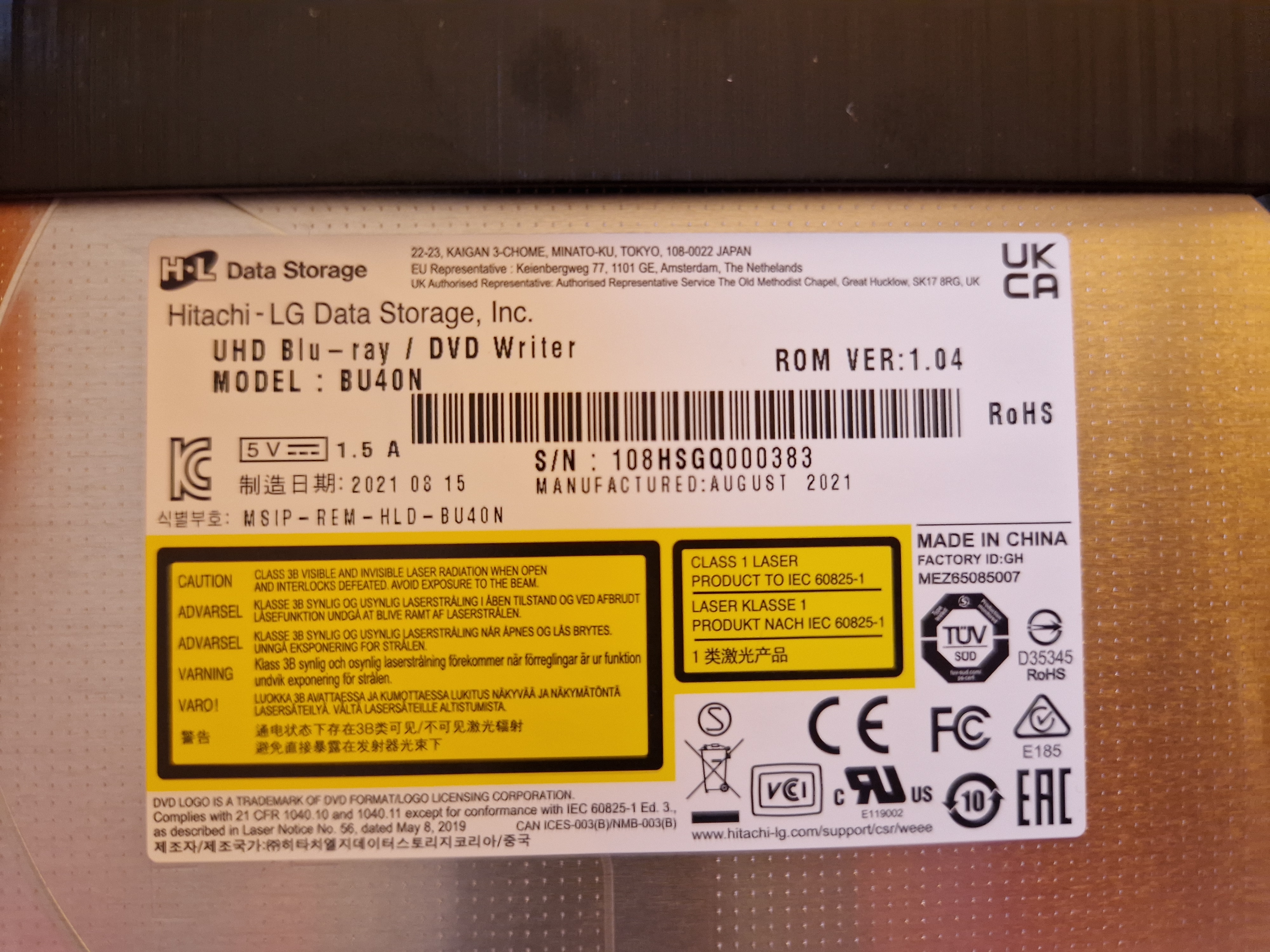

MadsKvist
Joined: Thu Aug 18, 2022 7:03 am
Post by MadsKvist »
Can someone help me out with this label? I don't see SVC NS50+ LG anywhere, it's it still safe to flash it?
Bu40 label
Bu40 label
