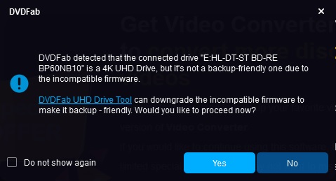

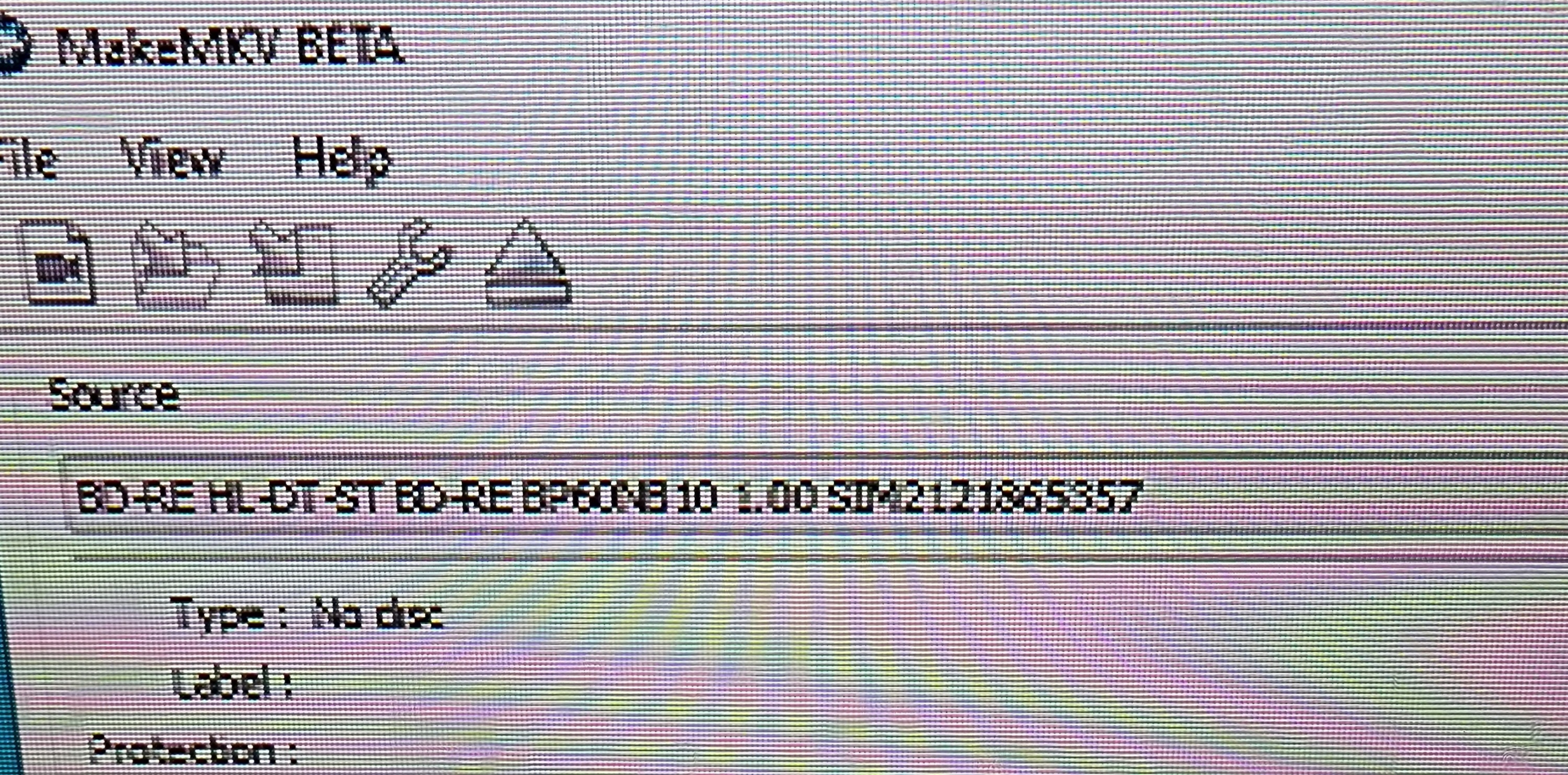

Re: SDFtool Flasher
Hey guys,
So I just picked up an LG BP50NB40, SVC CODE: NB52
I followed all the instructions on page 1 for this specific model and encourted no errors. It seems to be reporting as the drive in the final step so I think I did everything correctly, but in testing out my drive, I'm also testing out different software. Are these instructions specific to makemkv, or should they work with other rippers as well?
I have attached some pictures so you can see what I am talking about.
Thanks ahead of time

- Posts: 4849
Re: SDFtool Flasher
DVDFab does not seem to work with most MK firmware versions. I would leave the drive as is and stay far away from that garbage program.mvjunkie wrote: ↑Sat Aug 20, 2022 2:17 amHey guys,
