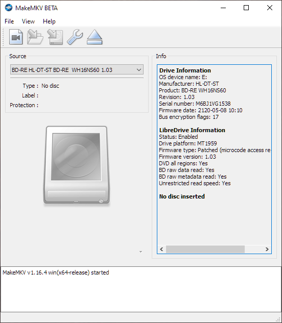

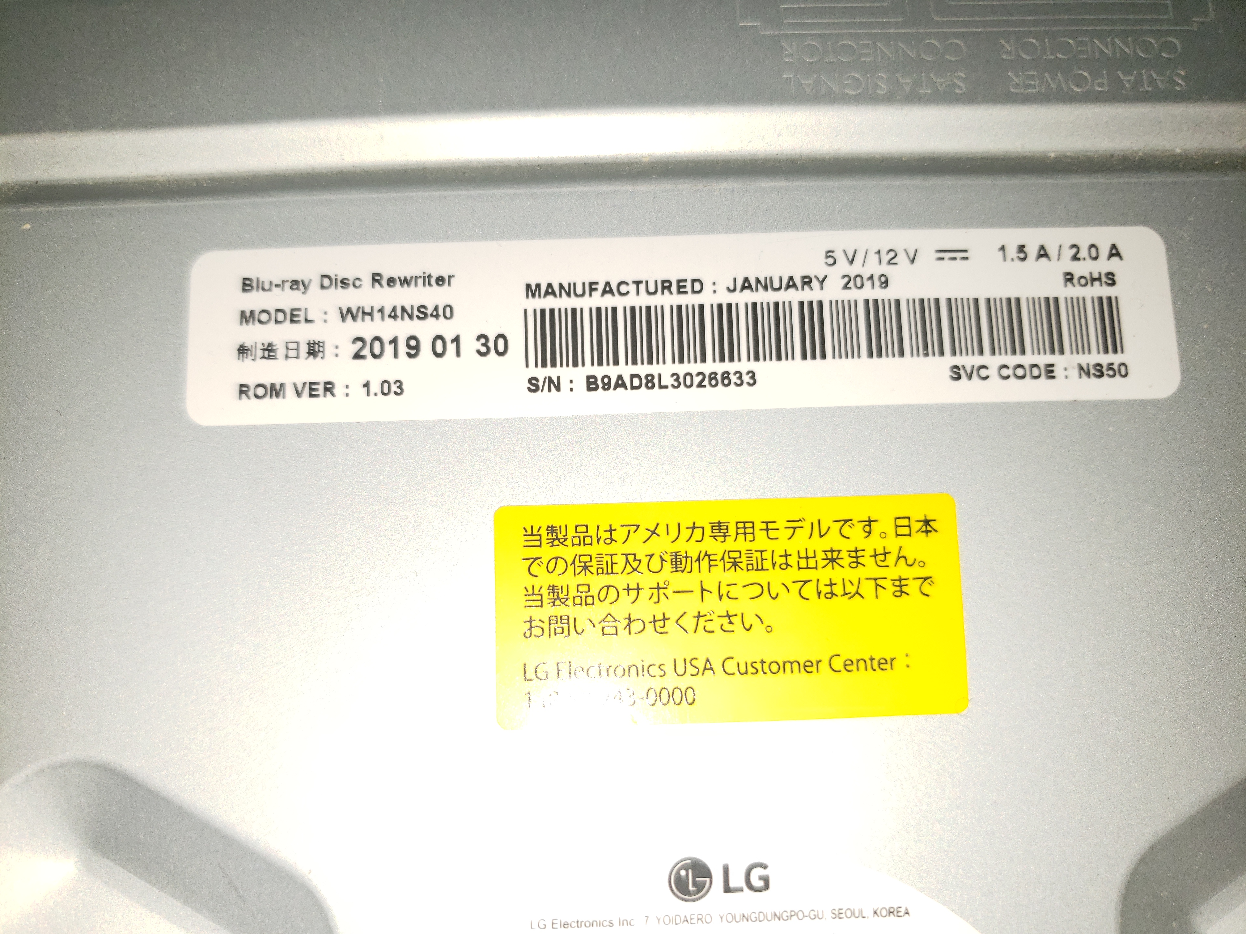

Hey,
I have a LG WH14NS40 Disc Rewriter. Had it for about a year and change, and use it with a janky sata to usb adapter with a 12v AC/DC adapter. I've watched probably 10 bluray discs with this. So today, I tried using it, and it did not read any discs. Which is odd. So I figured, it needed a driver update or something. Went to the LG website and updated the firmware to 1.05.
Then I fell into the MakeMKV rabbit hole.
Decided to downgrade to the WH16NS60 1.03 MK firmware. (which I think is the latest version included in the "mk-firmware-pack-20200720" zip.
Attached are screenshots of my MakeMKV details. And of my physical drive. I have a feeling I made a wrong step somewhere along the line. But I can't quite put my finger on it. Any ideas?
Also, sorry if this is the wrong section. As mentioned, I've been going back and forth through mike's and billy's videos/posts.
Thanks in Advance!

does not look like anything is wrong but if its still not reading discs try one of the adapters i list that work and see if it works then if not your drive diedYugiOhNO wrote: ↑Fri Sep 10, 2021 12:07 amHey,
Then I fell into the MakeMKV rabbit hole.![]()
Thanks in Advance!
