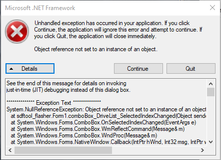

I just realized that this error message is popping up for the SDFTool.
Not sure if this has anything to do with the drive not flashing. Is there another flasher i could test? If so can you link me to it?

your drive is already flashed thats why its not working with enc once it flashed you dont need thatthejm wrote: Sun Jun 06, 2021 1:26 am Drive Information
