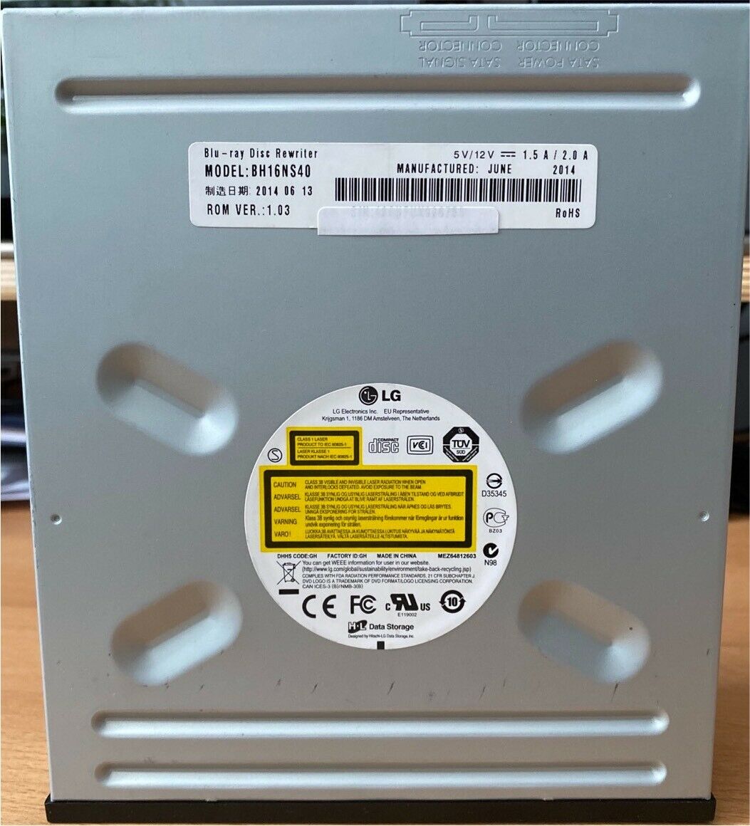

Hello all,
i could get 2 drives for an reasonable price but I'm not sure if these are flashable to UHD friendly drives.
Maybe one of you could help me :)
Posts: 10892
Re: Are these flashable for UHD friendly?
Both pre-date the availability of UHD-capability, so no. The hardware won't do it.
They should already be LibreDrive capable, which gives advantages, but that doesn't make up for the lack of UHD-capable laser assemblies.

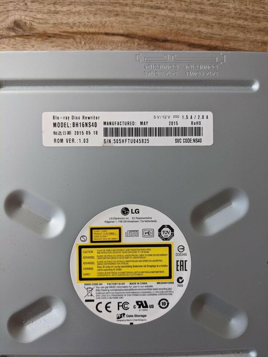

Post by Freaky69 »
Thanks for your reply.
I thought at least the 2015 drive was capable :(

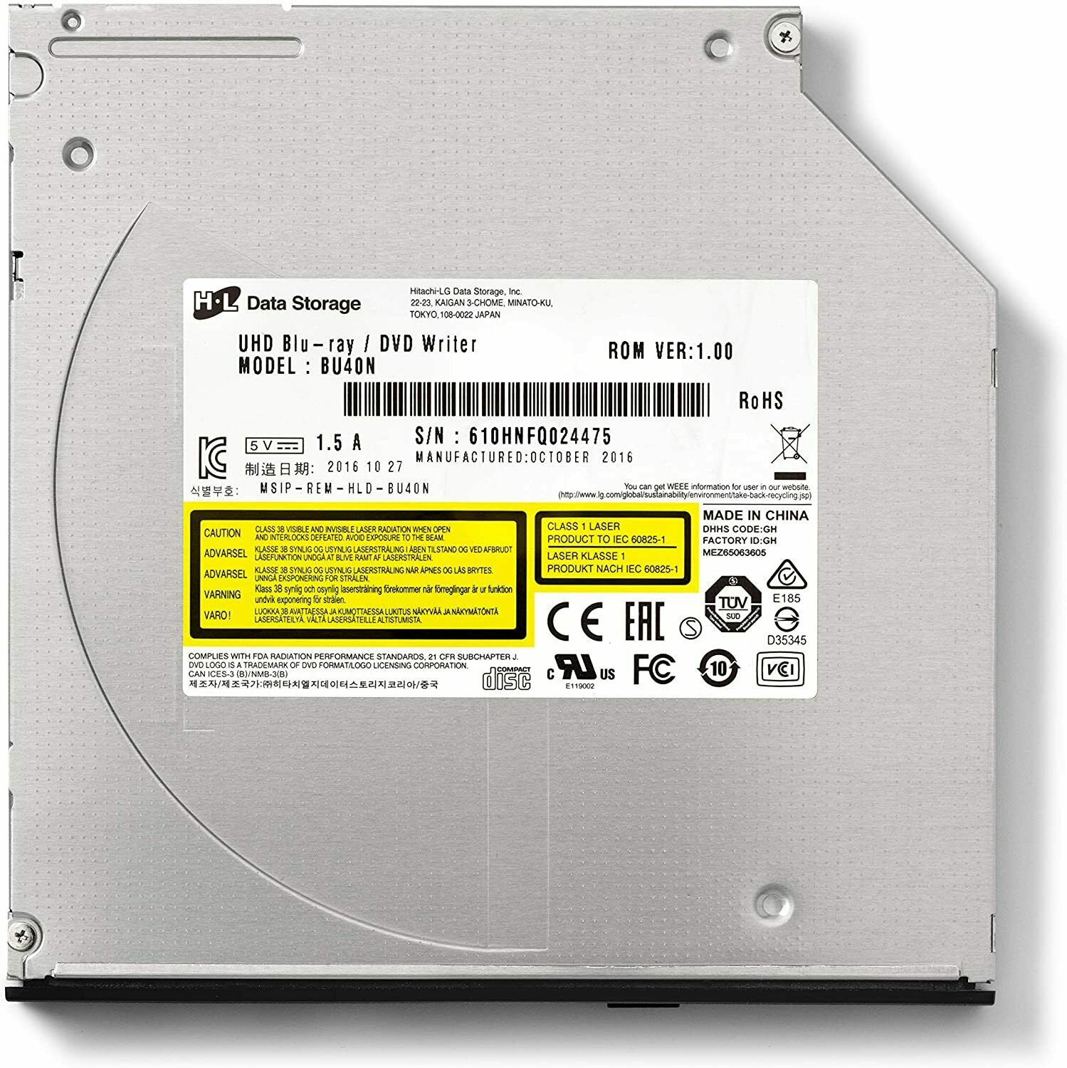

So the Buffalo / Hitatchi Drive should work i hear??
Posts: 5679
Freaky69 wrote:
Wed May 19, 2021 5:22 am
Yeah

Nevertheless i would like to know is there a fw available which isn't flashable?
Is the BU40N better than the ASUS BW-16D1HT 3.01?
I got the ASUS and sometimes it is very slow and produces Read errors but my standalone UHD Player (Panasonic) plays the disc fine!
Posts: 5679
Freaky69 wrote:
Wed May 19, 2021 9:13 am
I will hopefully get an actual picture from the drive (if the seller will response to my mail).
After that i will post the picture what FW is installed on the drive.
then we can talk about the self flash kit ;)
from my tests the bu40n is better than the asus.
all firmware is currently flashable

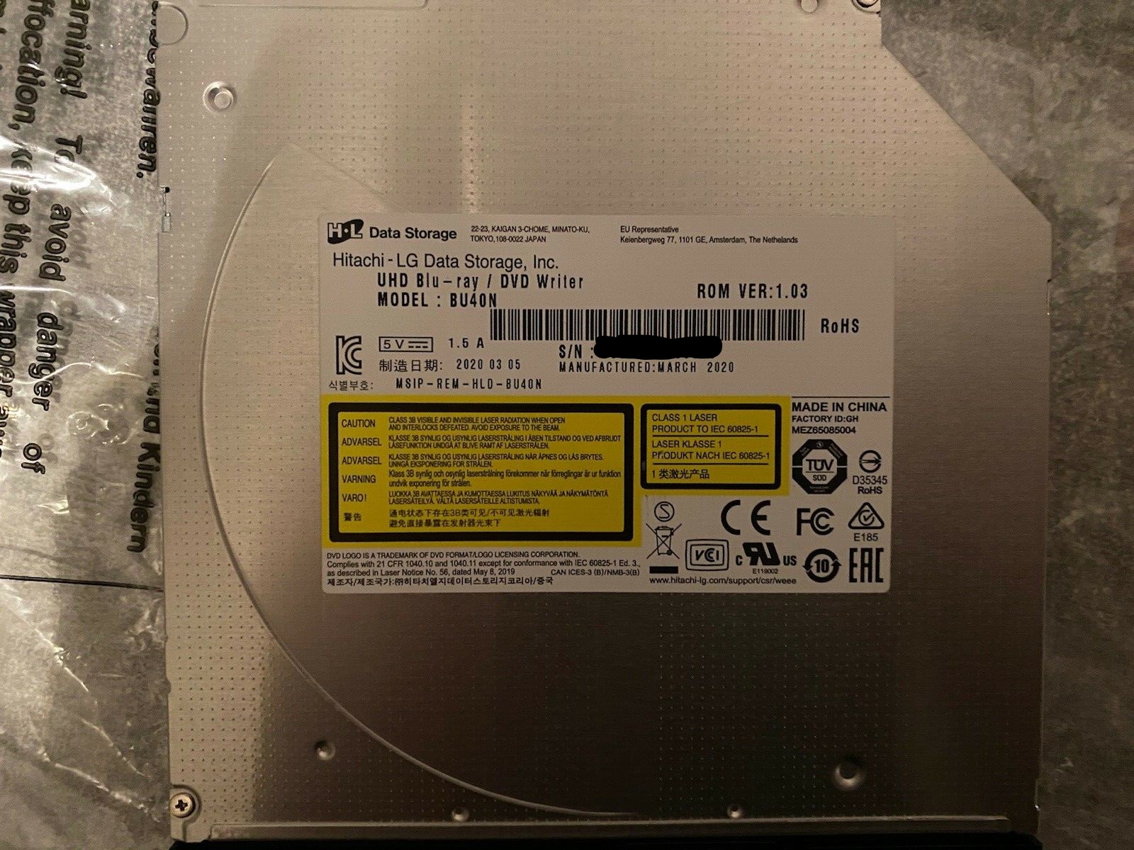

I just got the actual picture of the drive. It seems that there is the FW 1.03 installed :(
Is it okay to flash also?

Posts: 5679
Billycar11 wrote:
Wed May 19, 2021 9:31 am
But as I said your method to go directly to 1.00 de won't work
