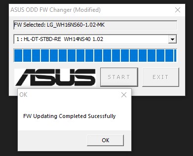

This week I purchased an LG WH16NS40 from Amazon Warehouse (they accidentally send me LG WH14NS40 with a mfg date of Jan-2017). This drive came with 1.02 firmware which was able to decrypt and create BDMV and/or MKV using MakeMKV. However, it would give an error when creating ISO using ImgBurn saying the disc is copy protected. I tried to update the firmware with 2 other methods
1. Command line option using makemkvcon64.exe f --all-yes -d H: rawflash enc -i "C:\Program Files (x86)\MakeMKV\HL-DT-ST-BD-RE_WH16NS60-1.02-NM00100-211810291936.bin") and
2. SDF tool flasher.
Both options did not update the firmware.
I was about to open a message here when I happen to come across this thread. I was hesitant but gave this ASUS ODD FW changer a shot and voila.. it worked.
Thanks for this thread and helping me update my drive.
- ASUS ODD FW Updated Screenshot 2021-05-16 111933.jpg (26.81 KiB) Viewed 41502 times

The command line and SDFtool flasher didn't work for you because you had "enc"in the command. Your 1.02 firmware is not encrypted!!liamtoh1 wrote: Sun May 16, 2021 3:39 pm This week I purchased an LG WH16NS40 from Amazon Warehouse (they accidentally send me LG WH14NS40 with a mfg date of Jan-2017). This drive came with 1.02 firmware which was able to decrypt and create BDMV and/or MKV using MakeMKV. However, it would give an error when creating ISO using ImgBurn saying the disc is copy protected. I tried to update the firmware with 2 other methods
