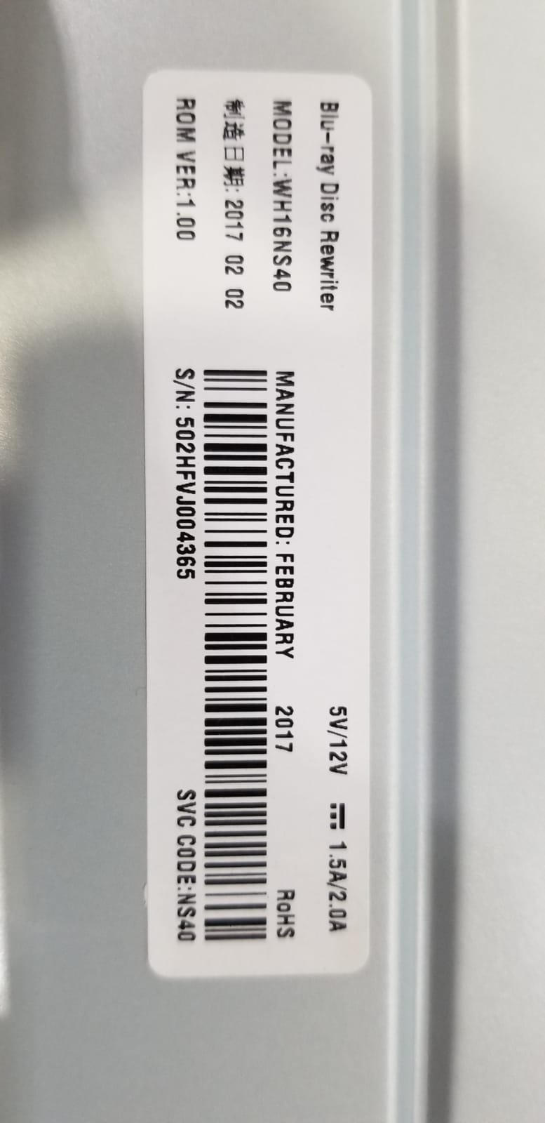

This is the first try on flash drive, just got a LG WH16NS40 SVC : NS40
Read the recommand modle, this is the cloest drive I can get, is it possiable to flash?
And any step I should attention?

Based on documentation, this drive is a bit of an enigma...
SVC Code: NS40, manufactured in Feb 2017
Transition to NS50 observed to have been ~Oct 2015? Sellers, ever seen such a thing?

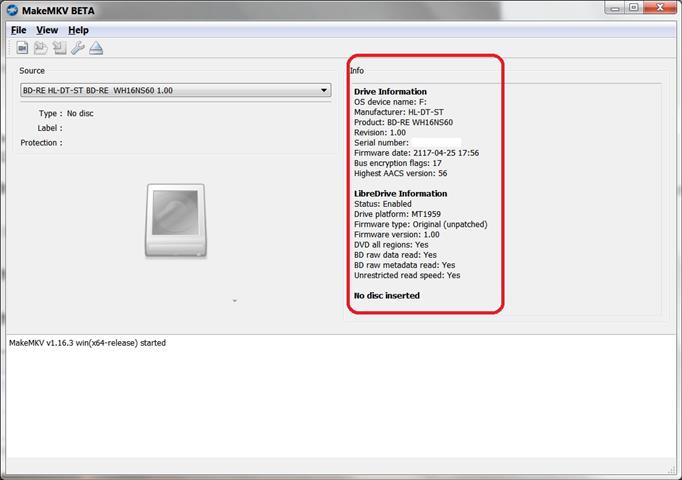

What does MakeMKV report in the highlighted section? You can copy/paste that info as text.
We'd like to see what is highlighted in GREEN, but w/ SVC Code: NS40, I expect to see MT1939, which DOES NOT support UHD. It can support LibreDrive, tho.

Yeah that's a weird one we need to see that makemkv drive info section might be an rma unit lg restickered
