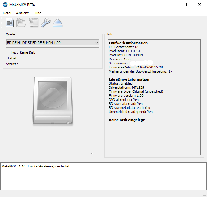

FlyByWire1
Joined: Fri Apr 09, 2021 9:21 pm
Re: SDFtool Flasher
Post by FlyByWire1 »
Hi there,
I own a MATSHITA BD-MLT UJ272 S 1.00 (Labels as TechPulse 120). Doing some research, but got confusing information. I read it is a Panasonic, or Pioneer device. Otherwise, it's said it is an LG BU40N. Anyways, I would like to get it UHD friendly if possible. Right now it's only BD capable. Would it be possible to unlock UHD function by flashing the firmware?
I already tried to use the flasher from this thread viewtopic.php?f=16&t=18873#p70284, but it did not work, cause the flasher doesn't recognize the drive (probably due to the controller in the external housing). The SDFtool Flasher, at least, recognized the drive, so I thought this might be working?
Which fw would be correct. I'm overwhelmed with all the different information, sorry for asking.

post your makemkv drive info section

FlyByWire1
Re: SDFtool Flasher
Meanwhile, I made some progress. The drive was not an BU40N, but I found another one in my shelf that is an BU40N.
With the help og Billycar11 I installed fw DE 1.00.
Screenshot 2021-04-10 155626.png (38.33 KiB) Viewed 25589 times
Any DVD is still reporting an error.
Screenshot 2021-04-10 160612.png (4.02 KiB) Viewed 25589 times
Would it be wise to install MK fw 1.04? I could not find out what's best.
Extracting the movie to mkv with MakeMKV worked.
Posts: 4749
Re: SDFtool Flasher
FlyByWire1 wrote:
Sat Apr 10, 2021 10:27 pm
God no! 1.04 sucks. Stick with 1.00
