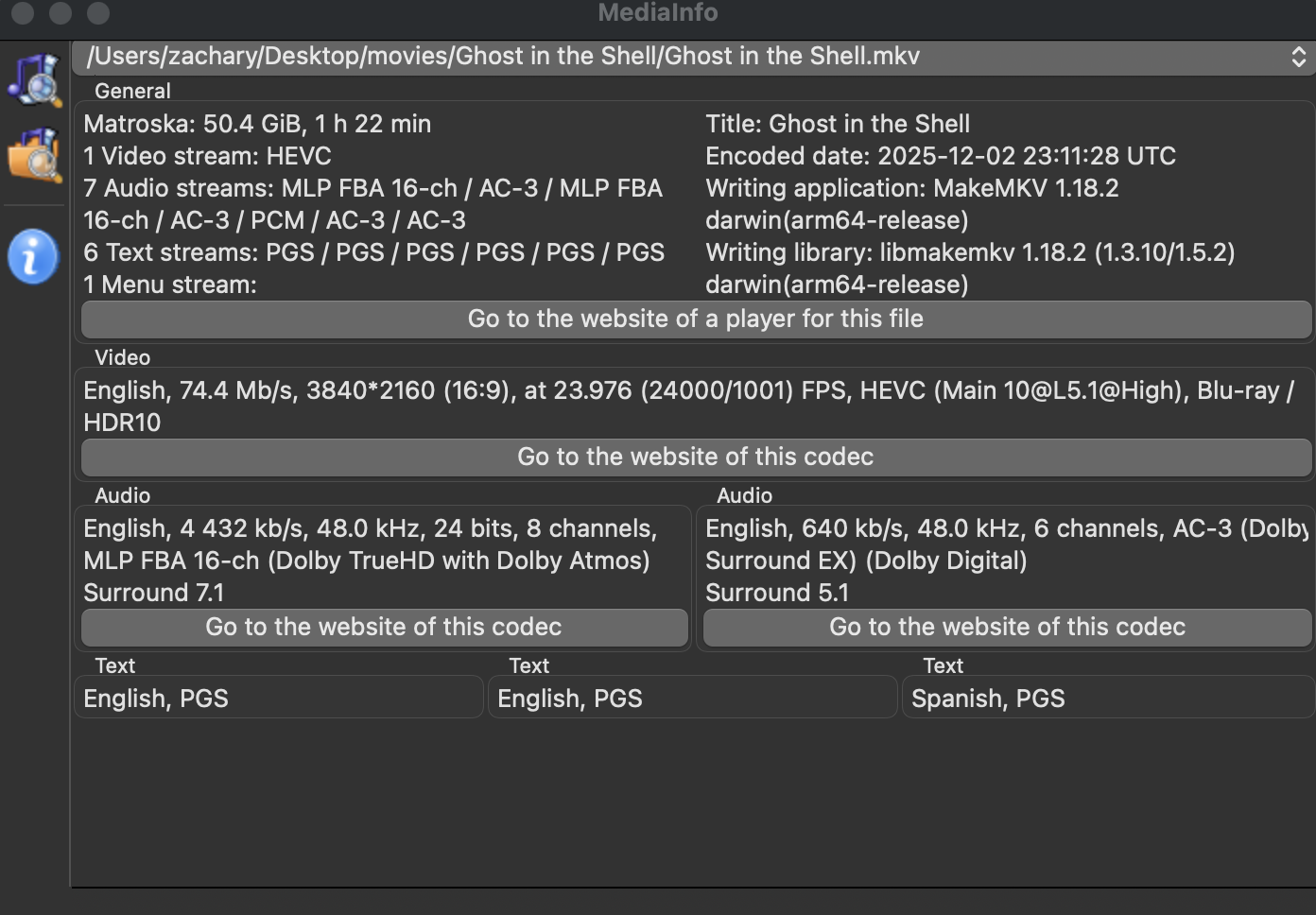

I'm not getting any information about DV at all when I rip a file. For context, this is what I get for media info with the original MKV Rip:
- Screenshot 2025-12-09 at 4.30.14 PM.png (247.7 KiB) Viewed 10373 times

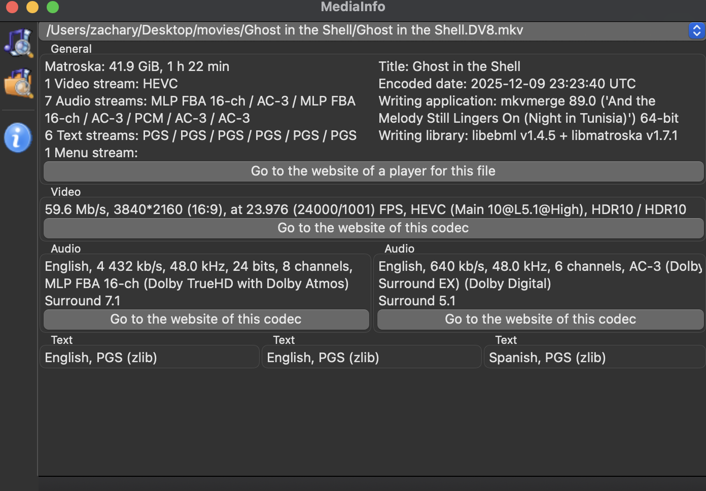

So update. It turns out that if I hover the mouse over the video information, I get a more detailed report. That is a very counter intuitive user interface. It turns out that using DV7 to DV8 is effective. Would it be possible to get an explanation as to why the file is smaller when I convert to DV8? Also, according to my tests in IINA, a lower bitrate as well.
