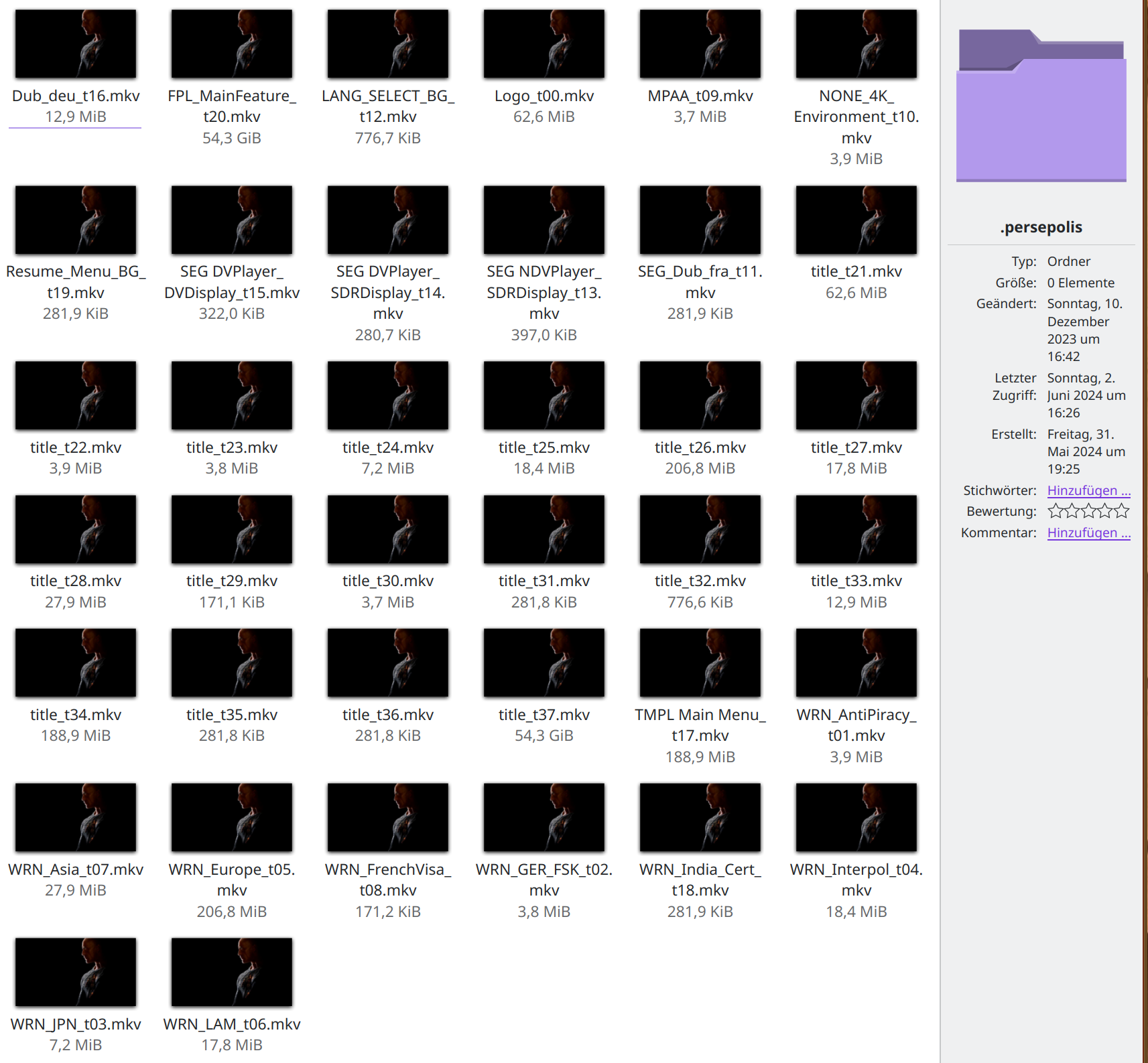

I have now figured out how to select subtitles and foreign languages, but I still don't have a start menu and my file order is arbitrary.
When I select the folder in VLC, it starts with the first file in it and that is the credits for the test bluray “Black Adam”.
How can I get the files to be saved in such a way that, when the folder is called up, the movie starts as if it were a DVD/Bluray/UHD in the player?
When I make a backup, I first have to rummage through the folders until I find the corresponding files with which the movie starts.
It should preferably be a file that contains all the data and is handled as if it were a DVD/Bluray/UHD. So that it is also easy to use for others.
At the moment I have 38 files with an unclear sorting. - which doesn't make things any easier.

MKV files do not support Blu-ray style menus. The MKV files you produced with MakeMKV are media files with no interactive functionality.
If you would like to retain the menus of your disc, you can instead use MakeMKV to create a decrypted backup of your disc. This will create a folder structure which VLC can play with the original menus.
