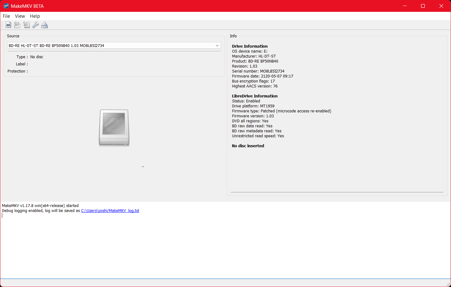

Can anyone tell me what i'm doing wrong? i've flashed the drive and everything seems to be right, but all that happens when i insert an uhd disc is it attempts to read for a few minutes and then says "no disc inserted".

Just the one disk, or all disks? You don't say, and some disks can have issues.

You haven't flashed it correctly. You have only done half the job. The first flash get's you to BP50NB40 1.03-MK. This is not UHD compatible. You must now do the cross-flash to enable UHD ripping. BU40N 1.00 is recommended.emperormephiles4 wrote: ↑Thu Nov 21, 2024 11:19 pmCan anyone tell me what i'm doing wrong? i've flashed the drive and everything seems to be right, but all that happens when i insert an uhd disc is it attempts to read for a few minutes and then says "no disc inserted".
Follow the guide (section about flashing BP50NB40 SVC NB52) in the SDFtool Flasher thread.

Thank you so much! it was driving me mad trying to figure it out!MartyMcNuts wrote: ↑Thu Nov 21, 2024 11:59 pmYou haven't flashed it correctly. You have only done half the job. The first flash get's you to BP50NB40 1.03-MK. This is not UHD compatible. You must now do the cross-flash to enable UHD ripping. BU40N 1.00 is recommended.emperormephiles4 wrote: ↑Thu Nov 21, 2024 11:19 pmCan anyone tell me what i'm doing wrong? i've flashed the drive and everything seems to be right, but all that happens when i insert an uhd disc is it attempts to read for a few minutes and then says "no disc inserted".
