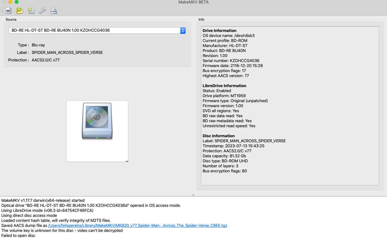

This is what I get, any suggestions? thanks.
Re: dump submitted spiderman across the spider verse
The C8EE file was sent in a year+ ago, and people were able to rip it after a few days, so... it would seem something is preventing your system from reading it.
Your log does not note that it tried to load the keys; is it disabled on your system? Normally, you would see an attempt to download the keys before it displays the "saving dump file" message.

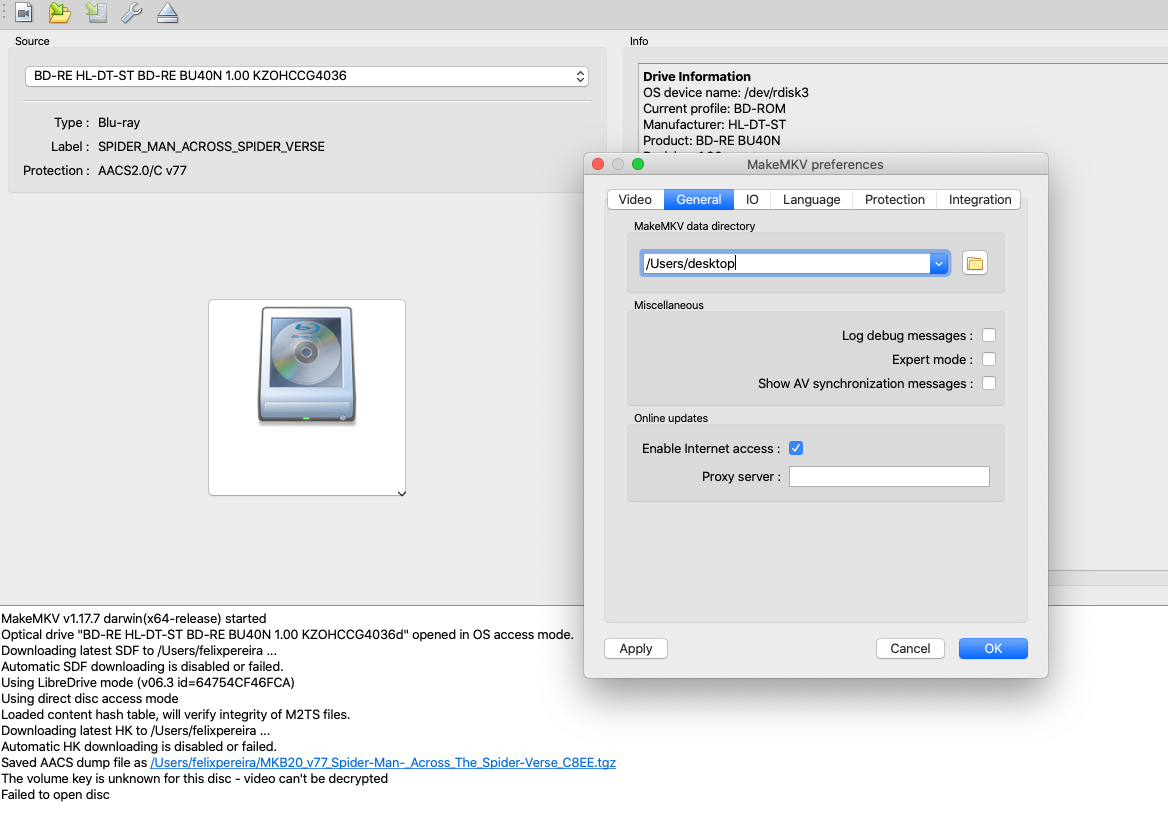

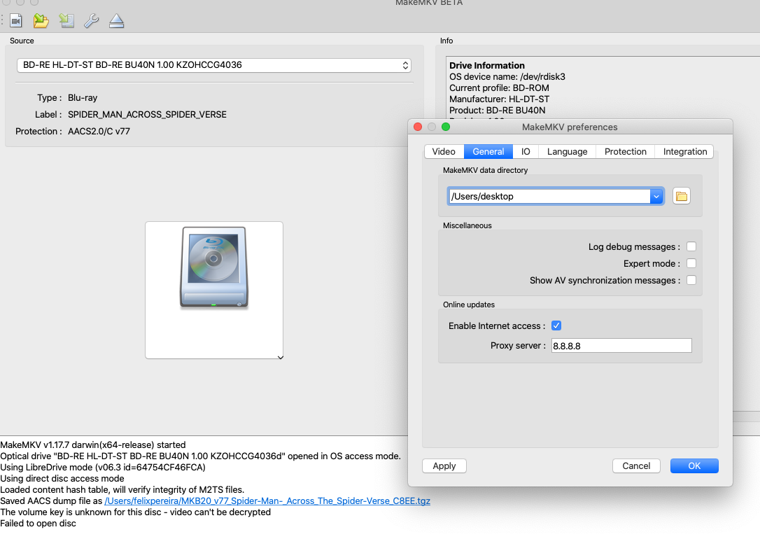

Enabled internet access is checked, and I changed the location of the data directory to my desktop, under proxy servers I had 8.8.8.8, then in the first pic you can see what it says, then when I removed the proxy server, left it blank, the second pic says SDF and HK failed, what should I put where it says proxy server? or should I leave it blank? weird. Thanks again.

OK, now it's trying to access the hash key file, but failing because your system is being blocked. You do NOT want 8.8.8.8 as a proxy server in most circumstances (at least not in MakeMKV), buy you do need to take care of the blocking of data download.

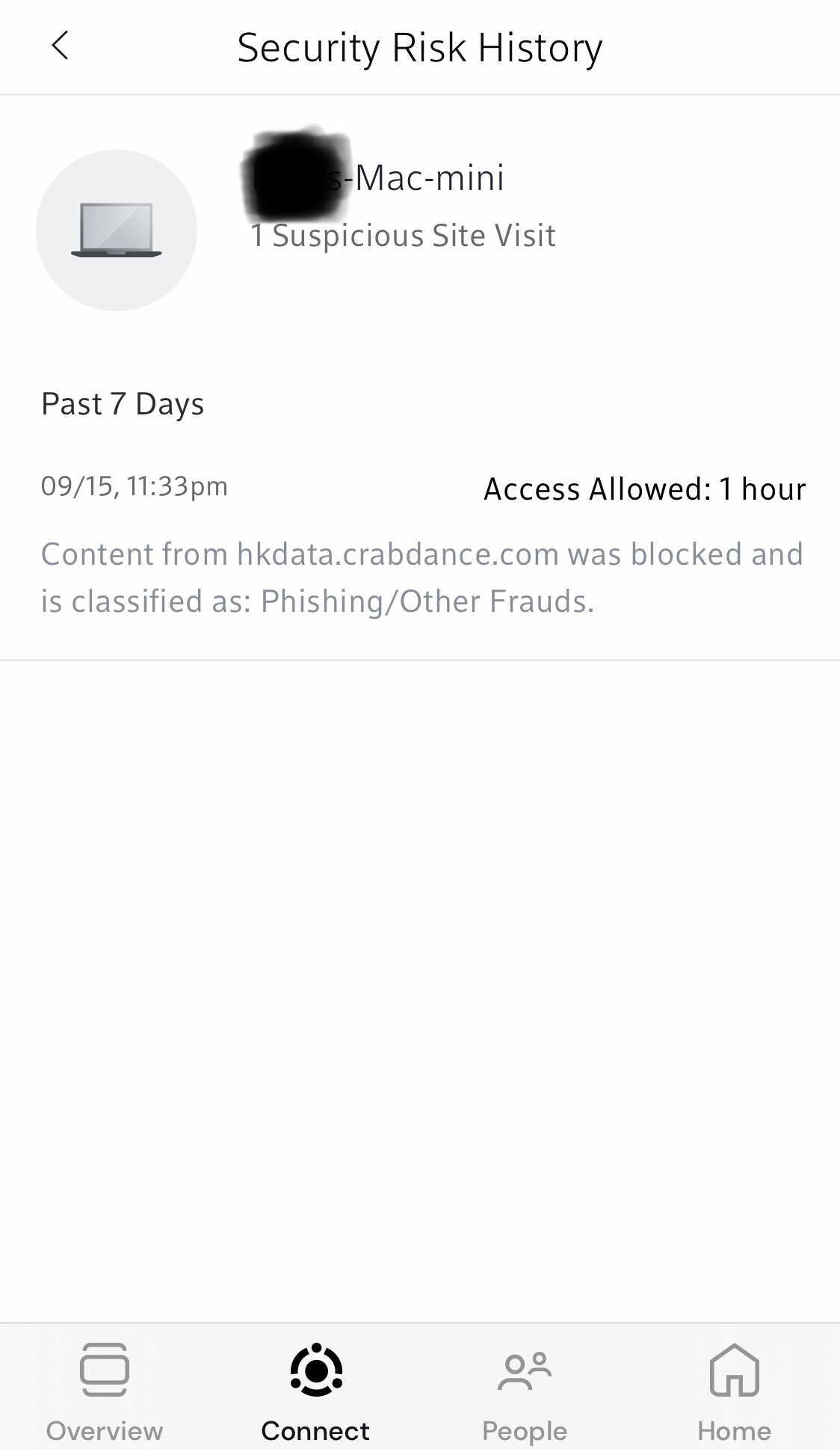

Can you believe this? I figured it out, went on the Xfinity Internet app under advanced security setting, for my Mac mini, and it said there was a site that was blocked, so I was able to unblock it and now it works. Thanks again.
- 79F57733-05F4-4B08-ABE2-1A74DD5FF003.jpeg (143.24 KiB) Viewed 4400 times
