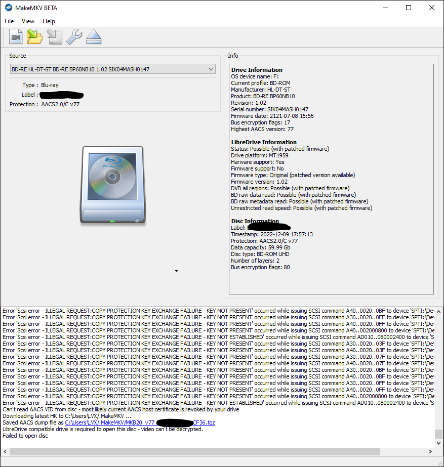

I have a new disc that I'm trying to make to rip to MKV. It is a UHD Disc - Brand New Purchase.
In going through the support forums I've tried to find a solution to the issue, but can't seem to solve.
Could someone please advise, I'd greatly appreciate it!
PLEASE HELP!!! - NEW UHD - Can't Read AACS VID / video can't be decrypted

Your drive is not set up to read UHD yet - you need to patch it, as mentioned in the LibreDrive Information.
That's what "Possible (with patched firmware)" means.

see guide linked below or buy an auto flasher from me or martysockpuppet wrote: ↑Tue Apr 11, 2023 10:17 pmI have a new disc that I'm trying to make to rip to MKV. It is a UHD Disc - Brand New Purchase.
