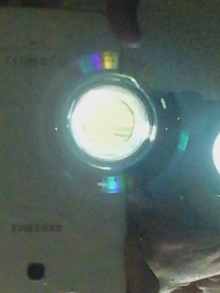

Does the laser try to read the initial info on the disc on the "smooth" part right next to the spindle? I noticed there is a "line" on that part of the 4k disc of the Deer Hunter...
I know this pic sux but it was the best I could come up with....note the strange "line" at the top right of the smooth section....could that cause the disc errors? BTW, that line in the picture isn't as pronounced when you look at the disc...I had to juggle a flashlight under my chin while trying to hit the friggin button on the tablet to take the picture without hitting the off button!

No that is not correct standard Blu-ray and UHD Blu-ray are different densities regular Blu-ray is 25-50gb UHD is 66-100.
Most defective drives I have come across only have trouble with the uhd discs

yes uhd bluray and regular bluray read different most defective drives i come across only have trouble with only UHD. your drive likely came defective from day 1 you can try cleaning the laser i would say you have a 25% chance of fixing it that way.bnormal1 wrote: ↑Sat Jul 25, 2020 10:14 pmBillycar11, would my 2 WH16NS40 drives read bluray discs differently than they read 4k discs? Does the laser react differently to a denser disc?
Also, based on what you said...my 2 drives may be defective however, they were both able to read 4 of the 12 4k discs I tried. I did retry 2 of the "good" 4k discs and they still work.
Maybe the drives are on their last legs?
also just looked up your movies on https://www.blu-ray.com/movies/Gladiato ... ay/200174/
every disk that failed is a BD 100 the hardest disc to read.
