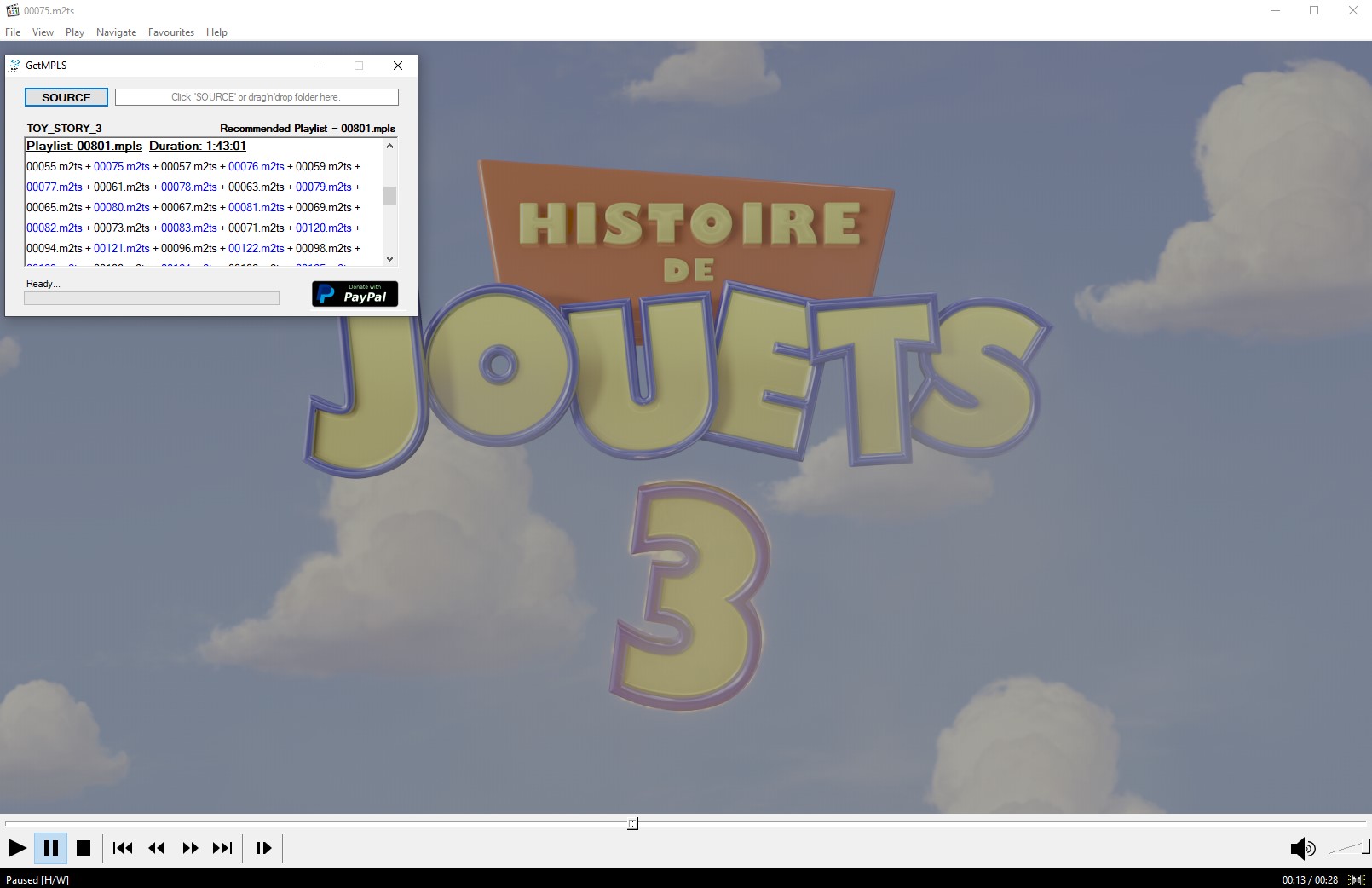

This pic shows an incorrect playlist has been recommended.
In this pic, I played the first blue m2ts file (00075.m2ts) from the incorrect recommended playlist (00801.mpls) and can see that it is in a foreign language.

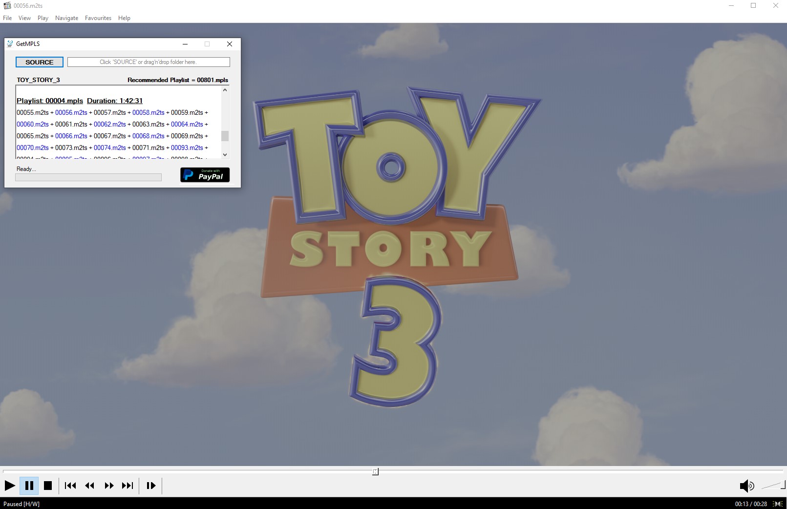

In this pic, I played the first blue m2ts file (00056.m2ts) from another playlist. As you can see,this file is in English, so for me, I can see that playlist 00004.mpls is the correct one. It also happens to be 30 seconds shorter.
As I said earlier, it does get it right most of the time, but if at any time you are unsure that the correct playlist has been recommended, just start checking the blue m2ts files and you will figure out the correct one in no time.
