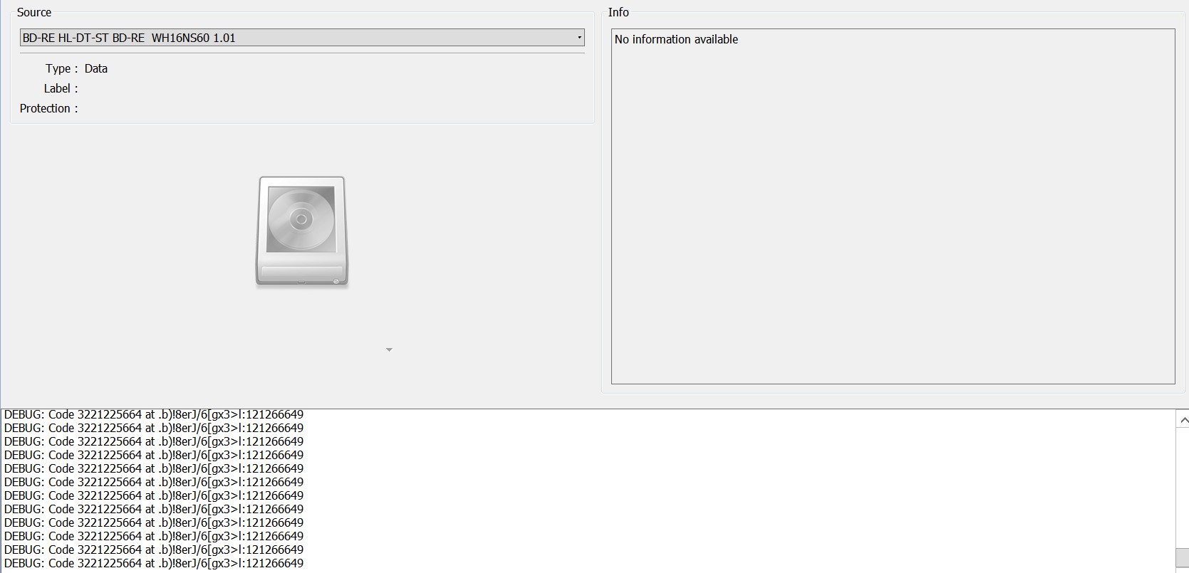

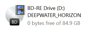

I tried this again in my LG drive (again), and it shows up in Windows Explorer, but MakeMKV just keeps spitting out the error code: DEBUG: Code 3221225664 at .b)!8erJ/6[gx3>l:121266649 repeated indefinitely... I should also note, after this error the drive no longer shows up in windows until I reboot.

I didn't have any problem ripping that disc multiple times. Almost seems like you managed to get two bad copies of the same disc but the odds of that I think are pretty high. I'm sure you've tried cleaning the disc and all that.
