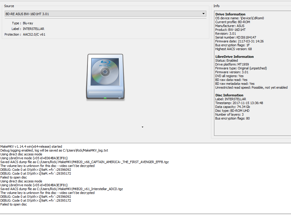

Still unable to rip. Volume Key Unknown Error. Sent logs for Interstellar on 8/27 and Captain America on 8/29. I have since uninstalled and reinstalled Makemkv. Manually updated with the sdf.bin file. I also went back and successfully re-ripped a previously known (to be good) UHD movie (Alien) to verify my drive didn't lose it's firmware (mojo).

Libredrive is enabled and trying to crack the disk(s) with no luck.I hadn't tried removing the privatedata.tar file yet. It did not make a difference. I have covered most everything else that is listed in the threads. I looked for several days prior to creating this account so I thought I covered most of my bases. I am not getting any of the errors that I believe relate to bad media, but I could be wrong on that. I am going to try and post screen shots below.

- Capture.PNG (85.31 KiB) Viewed 11339 times

I see I submitted log files instead of dump files on my first go around. This is probably my fault. Sorry for the error. I resubmitted the dumps and will check back periodically to see if they can be ripped. For those that are looking through the forums for answers, the dumps will be in the .makemkv folder, will be of the .tgz file extension, and have the name of the movie you are trying to rip in them. At least this is what I gathered from other forum posts as people would provide download links to their dump files and I could get an idea of what Mike wants from that.
